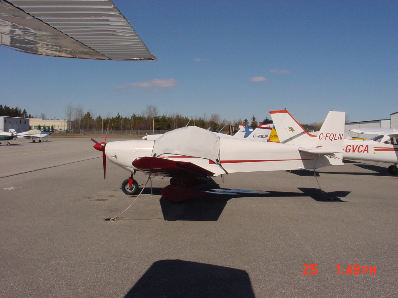

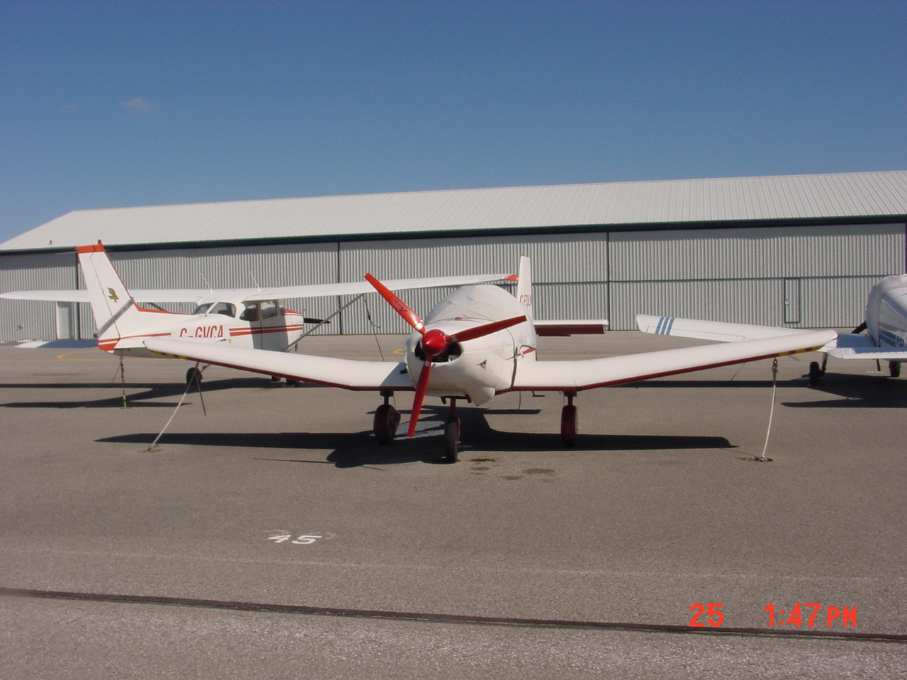

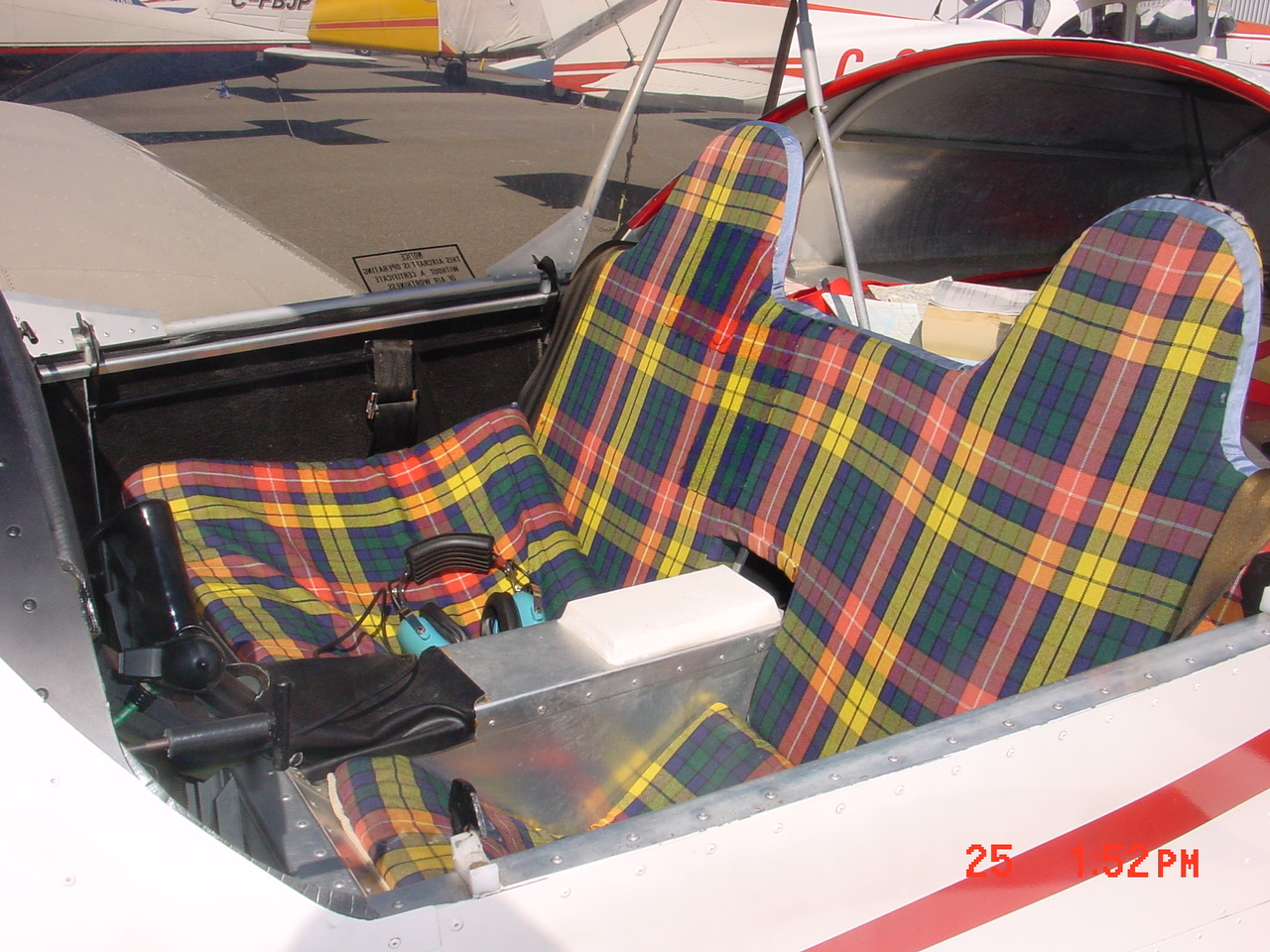

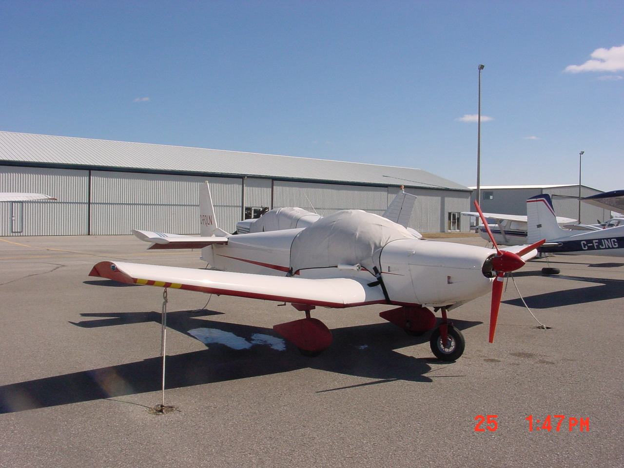

Hi Wayne,
Have you seen my latest ad? Yours for $22,000.00 and it has a electric boost pump and fuel pressure
gauge that works!
You know the a/c. I'm assuming you are over your problem. Back flying PIC again?
