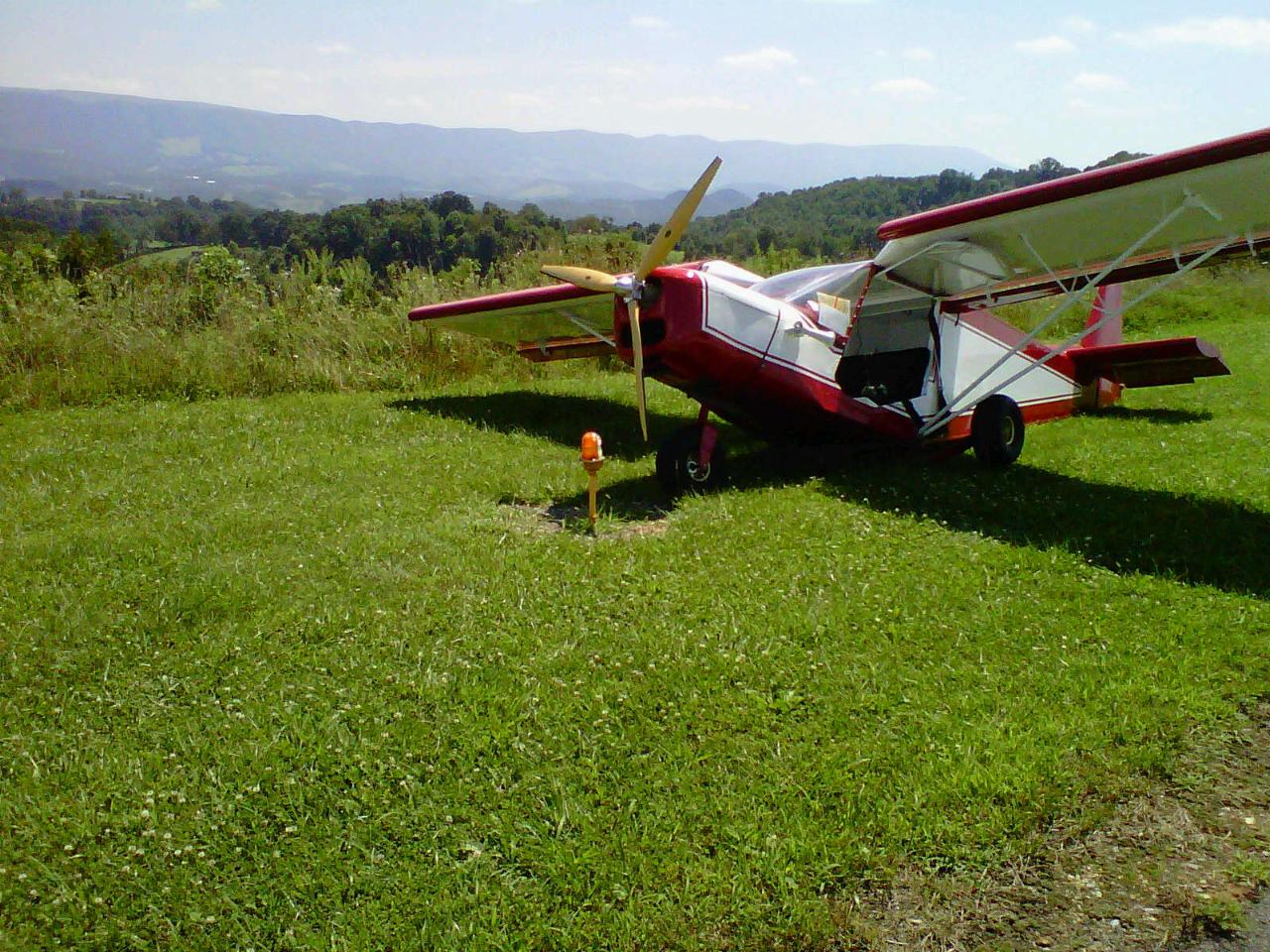

The spacers I am speaking of are the rubber spacers on the main gear. Mine failed last summer and I ended up having the main gear fold on me when I landed. I had heard a loud "pop" at takeoff from a grass field right at rotation and then recognized the gear hanging "askew" while in flight. I was able to plan the landing and to the glory of God, there were no injuries and.. not 1 scratch on the plane. I came in with a lot of throttle work and gently set it down on its belly in the grass. As soon as I got the belly down, I killed the engine to avoid a strike, but the front gear held fine. She came to rest like a dog sitting on her rear haunches. I still can't believe it... Absolutely no damage whatsoever to the plane other than bent bolts on the right strut fitting. I did replace that strut fitting.
if you search my posts, I think there are pics.
the security of my gear is something I check at every pre-flight and then again at taxi using the brakes and watching deflection. Very important.

oh yeah those spacers. Mine failed early on, but no gear collapse...I'm running pieces of tire in there now. That's held up well but I only have 220 hours on it. I'm trying to figure out how your gear collapsed without the clamp failing too...I can easily understand it being floppy and sweeping back some on landing but how did it collapse? I guess once it sweeps a ways it goes on and fails the clamp too? That's the bent bolts you mentioned?

Prior to the aforementioned takeoff, I had landed on the short field. I was probably just at gross weight and dropped it in solid... not a bad landing but not a greaser either. As best as I can tell, the top spacer sheared completely into 2 pieces at landing. I didn't pre-flight (my-bad) but just tookoff. As there was slop in the clamp assembly, as I went across the grass, the jolting caused the front of the aluminum bracket to break just as I lifted off. The back of the bracket held on but the gear tilted back about 20 degrees. As I remember that takeoff, I shiver. What if it had broken 1 second earlier, I was past the point of no return and headed over a cliff. whew. Again... glory be to God.
I didn't tell my passenger how bad it was but just headed to an airport with more runway. As I turned downwind, I handed her a fire-extinguisher and told her to pray.
I explained above how I landed her: a lot of throttle work and prayer. the gear folded back but stayed in the slot that runs beneath the fuselage. Not a scratch on the plane. I tell you the truth. Not a single scratch. How can that be?
It hurts to look, but I'll post the picture again.
fly safe.
