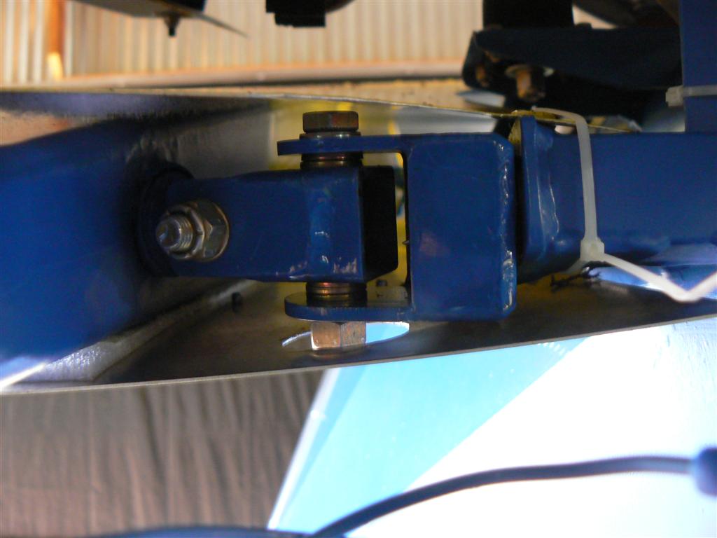

Before you put the trim tab on, hold off for a bit until I try out Kolb's new wing shim bracket. We now have about 2.5 hours on the FSII after the rebuild, and like most all 2 stroke powered Kolbs, it wants to roll left and yaw right under power.
Kolb sells a rear spar bracket that allows you to raise or lower the trailing edge of the wing, and tomorrow we will drop the trailing edge of the left wing by a couple washers and see what happens. The expectation is that it will pick up the left wing and center the ball. If so, no trim tabs needed. Maybe... We'll see...
Richard Pike
MKIII N420P (420ldPoops)
 Filesize:  68.75 KB
 Viewed:  16401 Time(s)
Richard Pike
Posts: 1671
PostPosted: Sat Feb 26, 2011 1:41 pm    Post subject: Re: Need Help with 582 rudder trim Reply with quote
The results are inconclusive. We dropped the left trailing edge about 3/16". The thinking was as follows: It wants to roll left and yaw right, so we will drop the left trailing edge to pick up the left wing, and the additional drag on the left side will pull the nose left and bring the ball back to the middle.
In hindsight 3/16" was way too much. It kicked the ball out of the box to the right as the drag on the left side went way up, and it still wanted to roll left. Also it just plain felt screwed up, since it was trying to fly cross-controlled with left roll and left slip.
So we put it back like it was and I came home - I had flown to a nearby airport for the EAA meeting and burgers, and the wind was constantly increasing as the day progressed, so had to cut things short. My strip is one way in, one way out, and landing with a ten+ mph tailwind is not one of my favorite things to do. So called it quits for today.
Will try dropping it just one washer this next week and see how that does. Also will call Travis tomorrow for advice.

Tried to do that, with the setting as shown in the picture, the wings appear to be at the same angle of attack, however in a power off glide, the ball is slightly out to the left, and the aircraft rolls left. Dropping the left trailing edge and then once again trying a power off glide the ball was way out to the right, and the airplane still rolled left with no changes in roll rate.
I am currently assuming that trim tabs are inevitable, but still open for suggestions on changing the wing angle. In theory (except that we rebuilt a wreck...) I would think it ought to glide straight ahead power off if everything is straight, and it pretty much is. Weather is supposed to be good for three days the middle of this next week, will be doing (hopefully) some more test flights.
To make sure I understand your suggestions correctly, let me read them back with a couple additions to make sure I got the picture. You fly the plane gliding level with the ball centered and then look at the ailerons to see where they are, and then raise or lower the wing with the washers until the ailerons are equal in trail. At this point, I assume that you could turn loose of the stick and it would continue to glide level?
Also at this point you could take your feet off the rudders and the plane would continue to glide straight and level with the ball centered? Or is that an unwarranted assumption, and getting that part fixed requires second step B? Feel free to make suggestions Jack, I consider you the guru in this particular area.

Today I changed the shim again, this time dropping the left wing trailing edge by just one washer. Went flying just before sunset, zero wind and turbulence. WooHoo! With with the throttle back to 3,000 rpm - which I am guessing to be somewhere around zero thrust at the hands off 45 mph glide speed - the airplane just barely rolls left, and the ball is almost centered. It is also very easy to hold the airplane level or roll it right or left with rudder. Under cruise power - which with the 582 is 5,000 rpm for 65 mph - using the stick to hold the wings level has the ball in the middle of the cage. Not sure why that is, wasn't what I was expecting, but I'll take it.
Tomorrow I will install the trim tab for the right aileron and see if that will have it flying hands off. Once it is, will see where the ball ends up, and if it need a tab for the rudder.
Bottom line: Kolb's funky rear wing attach bracket did the job. Thanks guys.
