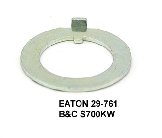

This is one reason why I've always recommended
that keyway engagement washers (shipped on all
products offered by AEC and I think B&C) . . .
be used on the BACK side of the panel. This way,
the hole in the panel for the keyway engagement
washer can be under a switch labeling placard . . .
or be so shallow that it does not penetrate the
panel. This allows one to have them above, below
or even changed after initial installation
causes one to discover the need to change it.
[img]cid:.0[/img]
Speaking of 'conventions' . . . you'll note
that the panel tab and keyway tabs are on
the same side of this locking ring. But
I've seen them on opposite sides too.
