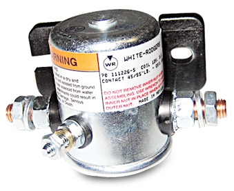

At 11:46 AM 2/11/2011, you wrote:
--> AeroElectric-List message posted by: "Jeff Luckey" <JLuckey(at)pacbell.net>
.. a quick glance at the fact sheet indicates that a non-latching version
is also available...hmmmm... so why do we (I) want one?
1. includes coil spike-suppression diodes
2. looks cool Wink
3. Price is not bad
[img]cid:7.1.0.9.0.20110211130251.01da57c0(at)aeroelectric.com.0[/img]
This is a direct descendant of the RPM/Stancor/White-Rogers
series of legacy contactors. The 70-111226 is a 3-wire
12v contactor with one coil internally attached to the
'BAT' terminal. It's the same class of contactor we've
been using in small airplanes for many, many moons.
 Filesize:  66.99 KB
 Viewed:  18228 Time(s)

starter can be disabled using the main contactor?
Yes . . .
Is the logic that the main contactor only has to do it *once*?
. . . or never. I've never experienced a
stuck starter contactor. I've only been aware of
a few incidents where B&C customers suffered
the event without benefit of back up for killing
power to the starter. Neither even destroyed the
starter but one really melted the battery box
case.
Remember that contactor service life predictions
are based upon switching certain kinds of loads
usually in a laboratory environment. Hence the
wide variation in 'ratings' for a switch or contactor
that control incandescent lamps, DC motors, windshield
de-ice heaters, etc. But in no case do we see switches
or contactors offered with less than THOUSANDS of
cycles at their various 'rated' loads.
So the notion that a 70A rated contactor (70
series RPM/Stancor/White-Rogers) is in mortal
danger for having interrupted a 200A stuck
starter once, twice or even a few dozen times
is not supported by experience or physics.
Having said that, there IS a situation where
an el-cheepo contactor is at much greater risk
for opening a out-of-ratings load. Figure Z-24
proposes controlling the b-lead of a runaway
alternator. If the voltage rises fast enough
during contact spreading, there is a risk
of sustained arcing between the fully spread
contacts. This is one case where the contactor
might experience a one-time event that leads
to it's destruction. But better it's a $25 contactor
than more valuable/useful system components.

... a quick glance at the fact sheet indicates that a non-latching version
2. looks cool Wink
3. Price is not bad
It's only a little more expensive than the "standard" can-shaped solenoids
http://www.aircraftspruce.com/catalog/elpages/masterrelay.php.
Mounting will be different.
If we use the latching capability, does is make circuitry simpler, more
reliable, better, stronger, faster, (will it help prevent icing? - sorry,
couldn't resist Wink
I'm w/ Bob, definitely needs more noodling..
-Jeff
