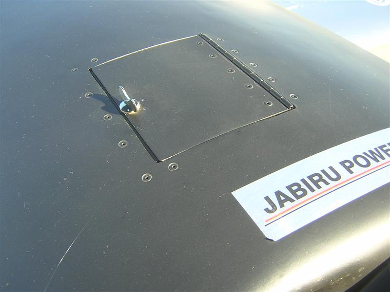

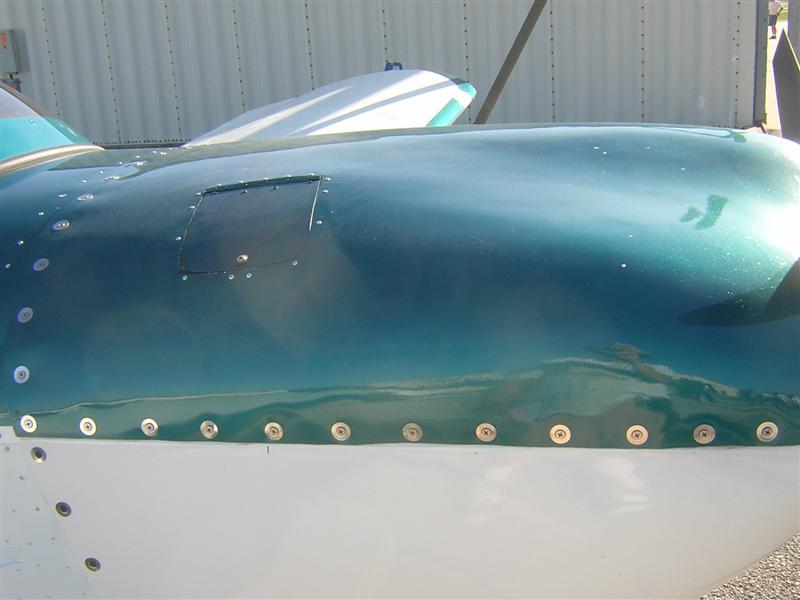

I'll also attach a couple of photos that I took at Zenair's Open Hangar
Days 2007. They do not show the mechanism, but both appear to use simple
piano hinges and Dzus type fasteners for the closure. 'Sorry, but I do not
know who owned those 601's.
