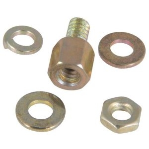

I will be using a d-sub connector on my removable rear Infinity Stick Grip. One of the connectors will be secured to the covering I will be fabricating to close off the floor opening around the aft stick. My problem is that I am not familiar with a means of securing one connector in this panel and yet still be able to screw in the other half of the connection onto the panel mounted connector. Any suggestions and sources for the means of accomplishing this task?
Take a look at the back of your computer. The stationary
connector is fitted with jackscrew sockets
[img]cid:7.1.0.9.0.20110115221237.01eb7900(at)aeroelectric.com.0[/img]
while the connector on the pendant cable is fitted
with jack screws of some variety. We had some discussion
here on the List a few months back about the convenience
of 4-40 capscrews with recessed hex sockets. But this
catalog page shows several of many alternatives.

That is exactly what I was looking for to make the connection. Thank you for your help and to all other responders!
