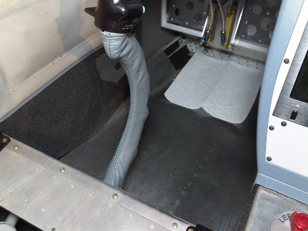

PostPosted: Sun Jan 16, 2011 6:43 pm    Post subject: Control stick connector Reply with quote
I did, I put a 90 degree bend in the upper stick. pretty much followed Tim
Olson's site for doing mine. Looks much cleaner to me, but it does take some
work to make it come through the tube to the bottom. Not hard and looks much
more mice than leaving it on with zip ties. A small boot off the bottom
panel into the flightstick and painting the stick would be nice. I think I
took this picture from Greg Hale's site.
With that said, a full flightstick boot would cover the stick as well and
look equally nice.
Pascal

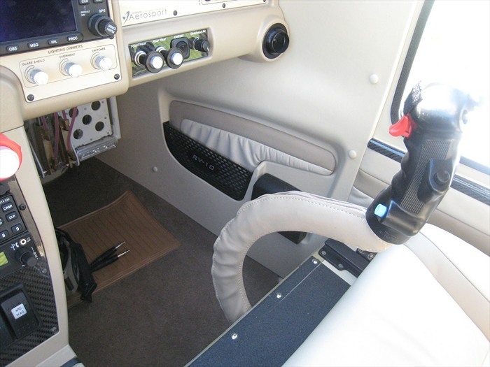

PostPosted: Mon Jan 17, 2011 7:27 am    Post subject: Control stick connector Reply with quote
Here are some picture of the stick covers I made for my sticks. I have the
cable on the outside of the stick and these have a nice zipper in the front.
I have made these for some other builders as well. They are very easy to put
on.
Geoff Combs

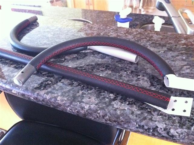

PostPosted: Mon Jan 17, 2011 10:21 am    Post subject: Re: Control stick connector Reply with quote
I had a steering wheel reupholstery guy wrap the control sticks and the windhsield bar with black leather and red stiches. I'll be running the cables inside the sticks.
Lenny
