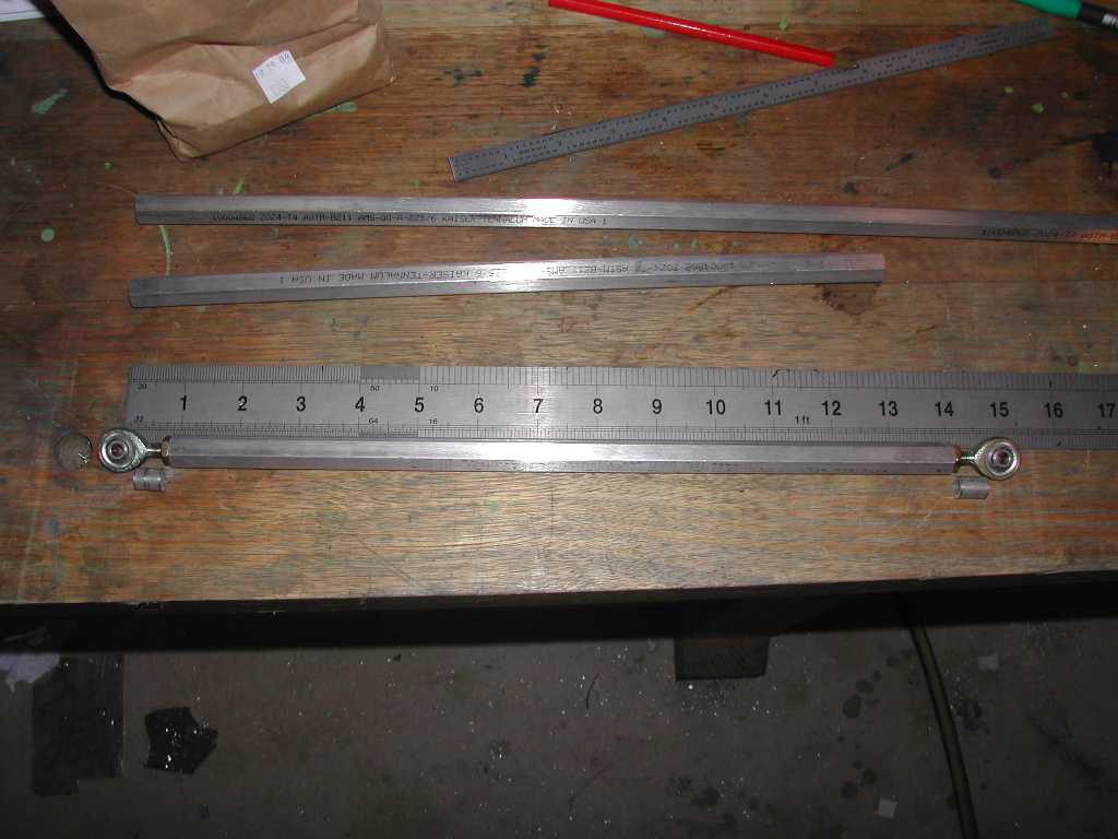

Howdy all,
I was working the aileron pushrod assemblies yesterday. Figure 2 of 39-2 indicates an F-1064 length of 12 5/8". The supplied F-1064 in my kit is 13 1/16" (for both pushrods). Interestingly, the supplied F-1065 is 20 1/2", the same as called for in the plans.
When the 30 1/16" F-1064s are used with the 1/2" pushrod sleeves, the total assembly length comes in at 15 1/2", well over the 14 7/8" called for in the plans. If the two pushrod sleeves are removed, the assembly can easily be adjusted to 14 7/8". Photos attached.
Obvious solution is to trim the F-1064s to the correct length. But these are pre drilled and threaded and trimming will also remove some of the thread. I don't know whether there will be sufficient thread depth if trimmed. The other option is to halve the size of the sleeves, or exclude them all together.
Pictures on other web sites (eg Tim O.'s) have the collars included. If the F-1064 length is maintained at 13 1/16", why are the collars required? Have others experienced this problem?

Ron, Wish I could be of more help and tell you if I cut them or not,
but whatever I did, I had them be to the exact plans length, so there
was no fudging involved. I wish I understood what that collar was for
too. My only thought was that it perhaps shields things that could be
rubbed by the threads on the rod end, but that would seem strange that
you'd even have anything that close to the rod ends. Mine are
loose on the part, since the jamb nut is up against the hex piece
holding the rod end tight, so the other collars kind of float free
a bit.

I actually got one rod 12 5/8" and one 13 1/16", so I called Vans. They
said they were changing to the longer rod and eliminating the sleeves.
Just put them together with out the sleeves.

Mine were the longer rod and no collars (sleeves)
John

For those yet to hit this point, response from Vans:
"Current DWG 39-5 (Rev 1) shows 1064 13 1/8 for hex rod and overall length 14 7/8. F-1065 is hex rod: 20 1/2 and overall: 22 5/8.
There are no sleeves, just rod-end bearings and jam nuts.
If these lengths of pushrod are in your kit, I would expect DWG 39-5 to show this. Check to see if you have revision 1."
I have rev 0 of the plans. Checked Vans website and there is no rev 1 in the "Service Information/Revisions" Section. Does anyone have a list of the CURRENT drawings by any chance? I wonder how many other drawings are out of date (a good chunk of Sections 26 and 29 I bet!)
