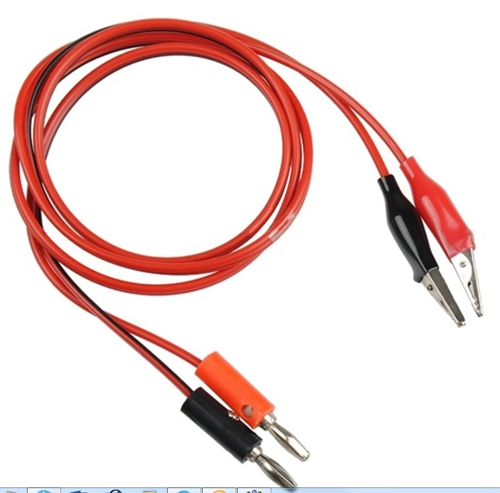

I'm having the same need as the OP. That is, low displayed voltage from my IR alternator. I understand the directions but do not know how to implement them on a running airplane. This may be an electric 101 question. How do I physically check the alternator output voltage at the alternator's b-terminal? I don't have anyone willing to reach in and hold the voltmeter test leads on a running airplane.

Easy, don't PROBE the points of interest, CLIP them.
I very seldom use 'probes' for any measurement, virtually
all signals of interest need to be sampled while your
hands are fully occupied with other tasks.
[img]cid:7.1.0.9.0.20171007183910.003ce7c0(at)aeroelectric.com.0[/img]
I have several dozen clip leads sets in the various
tool boxes and workbenches. As a general rule, I make
them up with a minimum 36" long. I have a couple of
sets that are 10' long. I once built a special clip
set about 40' long to watch a voltage in the 'hell hole'
of a Beechjet whilst I was fiddling with knobs in
the cockpit.
Built yourself a 10' pair. Clip to points of interest
under the cowl then sit in the cockpit taking voltage
readings ar various rpm and loads. Tape the leads
to under side of cowl to keep prop wash from shaking
the wires so bad that it pulls the clips off . . .
been there, done that.
