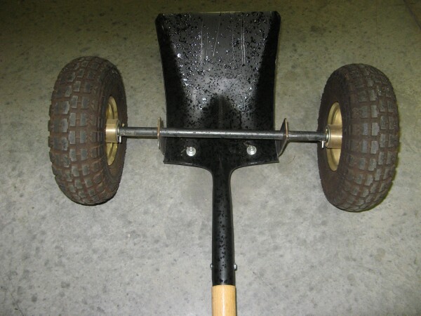

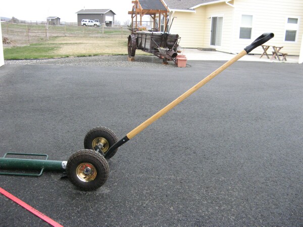

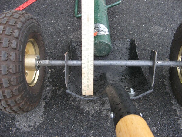

Dave, I can move my kitfox around on the gravel with the wings folded with my tail wheel scoop. I can even scoop up the tail after the wings are folded. The wheels are 10 in pneumatic from harbour freight.
http://www.harborfreight.com/10-inch-pneumatic-tire-30900.html
Feel free to copy and modify the design if you want. Wink

This might work if the surface is packed down pretty good. I tried some narrow hard rubber wheels on my proto type but they would dig in with the wings folded on my gravel driveway. You could probably easily put a pair of the harbor freight pneumatic wheels on it for use on a soft surface.
Tom, Ingenious tailwheel scoop? Is it FAA�certified
I have an STC for use on Certified aircraft. You will have to send me $25 if you want to use it on a FAA certified aircraft. No permission required for use on a kitfox. Wink
