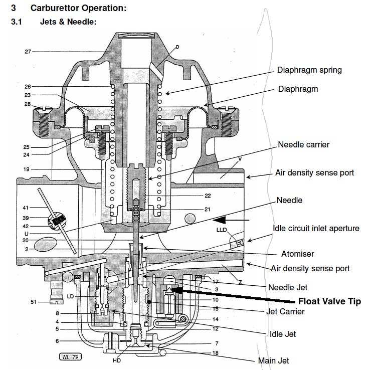

After thinking about it for a moment I realized that you can't get deep enough into the Bing 94 carb to inspect the float needle valve tip without removing the carb and removing the float support mechanism which requires removal of the float hinge pin which is item 14 in the attached image. I hope this helps.

thanks for the diagram.

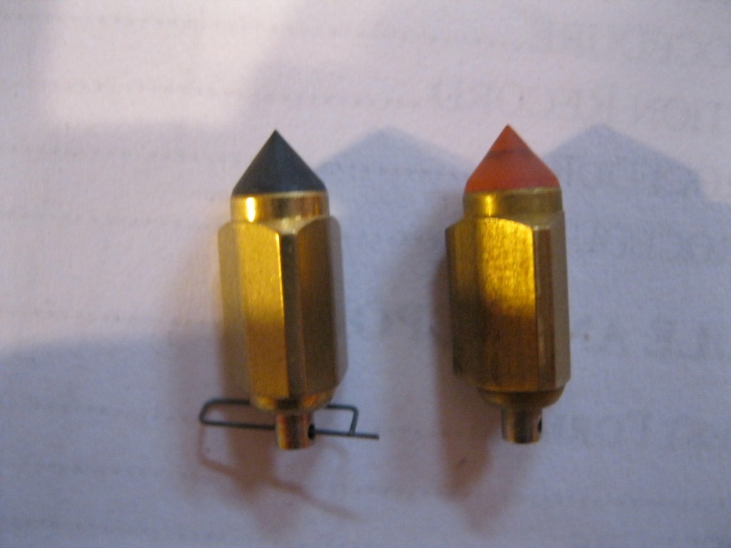

I got her going yesterday with the new float needle valve and she seems to run good....taxiing out I thought it stumbled for a second and returned to the hangar to run it up again,but all sounded good, so up I went. I ended up taking the carb off to install the new needle and will remove if it has to be done again later on ( hopefully not) !
The pink one is the old one...black tip is the new......the video was part of the test flight yesterday...
