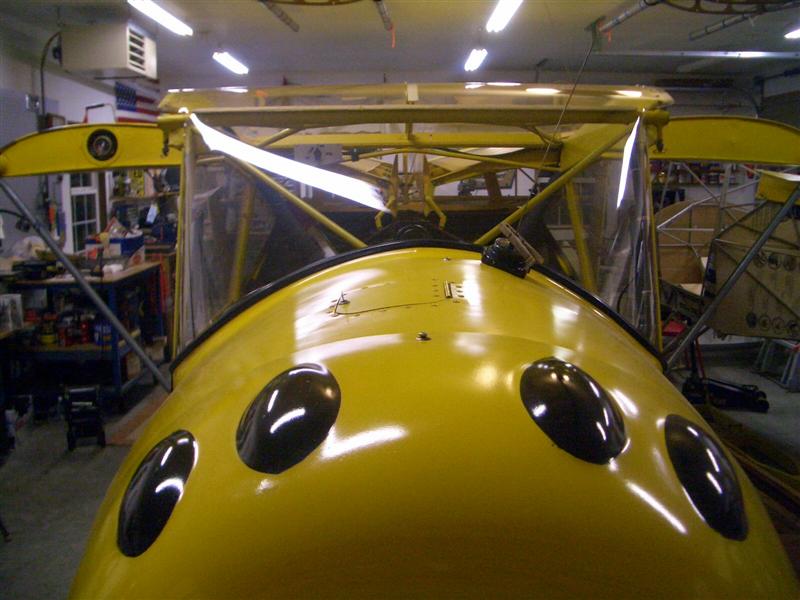

After: New windscreen and skylight installed.

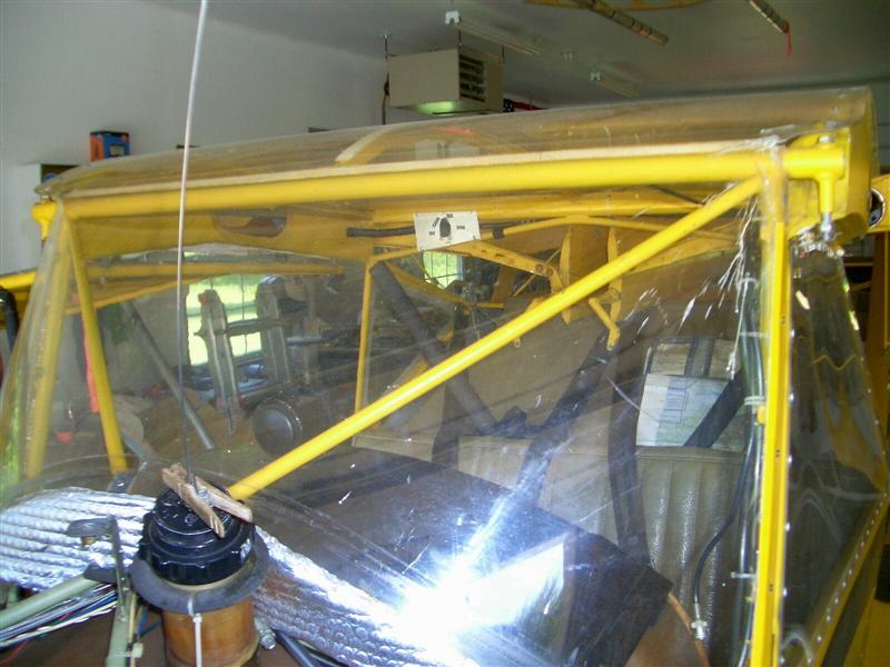

Before: Badly crazed windscreen in need of replacement.

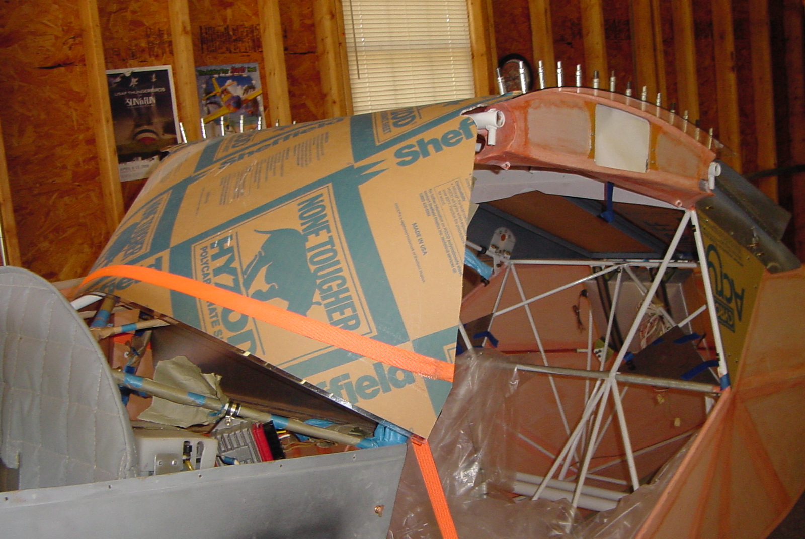

PostPosted: Wed Dec 29, 2010 6:10 am    Post subject: Re: new old topic windshield fitting Reply with quote
I also used heat and cargo tie down strap to help contour the windshield during my build.
 Filesize:  820.3 KB
