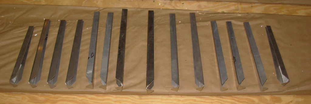

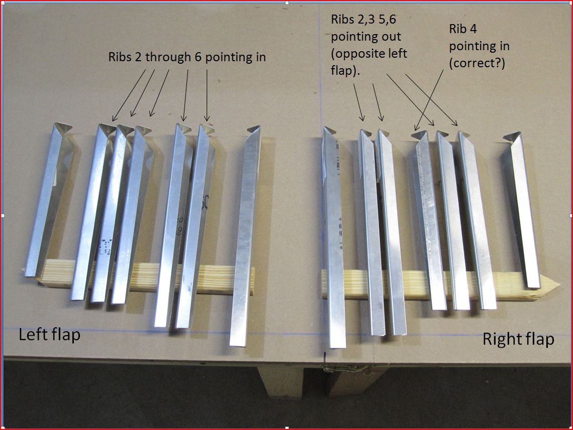

Ok, so I'm a bit lost on the wing flap ribs and their placement. I sorted them all out using the plans, but think I was sent too many of one side and not enough of the other. I was wondering if it matters which way the inside flap ribs face. The outside ones (ribs 1 and 7) on both side are opposite each other and look ok. The inside ones however all point one way on the left flap. On the right flap most of them point the same way as the left flap with the exception of one, it faces the other way. I took a square and made sure I had the 90 degree angle on top so the angled portion is on the bottom as they lie on the bench. I included a pic to show how I have them laid out. Anyone know how these are supposed to be installed within the skins?

From looking at the drawing 640-A-4, I would say ribs 1 thru 6 solid surface inboard and rib 7 solid outboard.

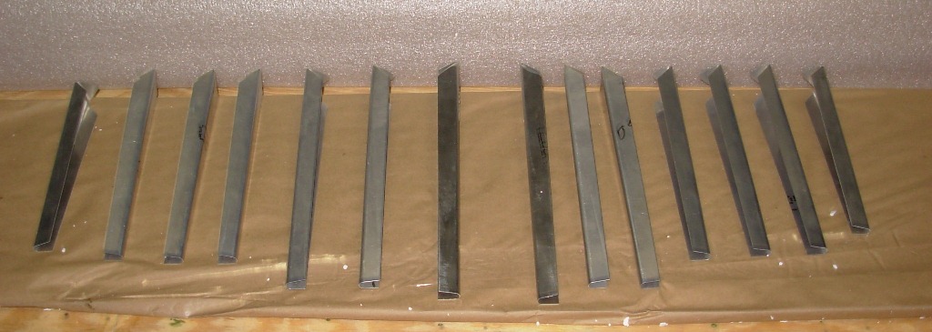

So I unpacked and laid out the ribs I received. The arrangement is based on the 90 degree marking that Zenair placed on one corner of each rib for reference.
It looks as though Zenair doesn't much care which way the internal ribs point, just the ones on the ends.

By looking at the drawings, it would seem that structurally it shouldn't matter which way they face. But the drawings DO specify which way they should go. I did call Zenair, but about something else. That was 3 weeks ago and still no reply. It is the holidays however and they ran and grabbed a -640 specialist to answer my questions. I didn't ask about the flaps because I hadn't realized the problem at that point. I am ready to install the ribs into the right flap. Everything is pretty straightforward. I'm just being cautious about the hinges. I'm not happy with the way they ended up on the stabilator trim tabs. I want these to be better, but don't yet have a good method for doing it.

So I finally spotted the definitive answer for the flap rib orientation question. DWG 640-A-5 R3 Flap rib table. Ribs 1 and 7 show 1R, 1L in the # reqd column. Ribs 2 thru 6 only show a number, no RL reference. I doesn't matter where they point.
