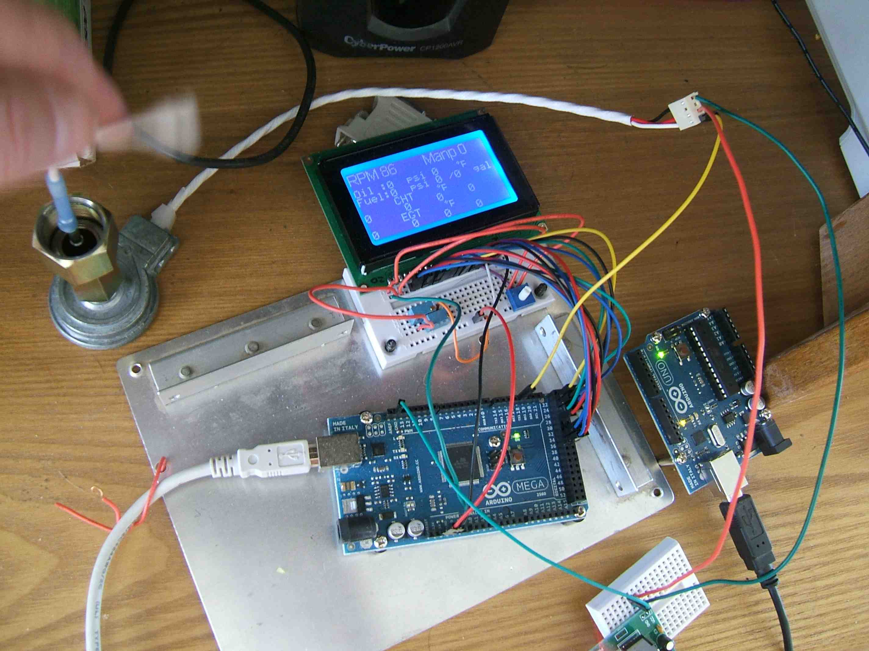

If you search around the Van's website there are installation notes on the various guages they sell and a drawing showing how they are typically wired.
If you put say, 5 volts (instead of 12v) and slowly rotate the spindle on the sensor you will see it generate 8 steps of 4.26 volts. If you hook it up to 12 volts, you'll get comparable results. Since the sensor is typically attached to the camshaft, there are 4 steps from the unit per crankshaft revolution.
attached is a jpeg of a digital tach setup I'm breadboarding for my rv7 using the little Italian arduino boards.
The van's gauge if you take it apart and peruse the circuit board you will find it uses a frequency to voltage chip to drive the guage.
Sorry about the size of the jpeg...
