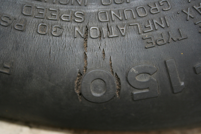

The nosewheel on my 18T developed some sidewall cracks with 60-70% of thread left.
Which of the nosewheel tyres give the best service?

According to Desser, they will not retread a tire that has cord showing or sidewall cracking. You can ship your tires back and they will retread them for you and return your original tires to you. That assumes the tires are "acceptable" for retreading.

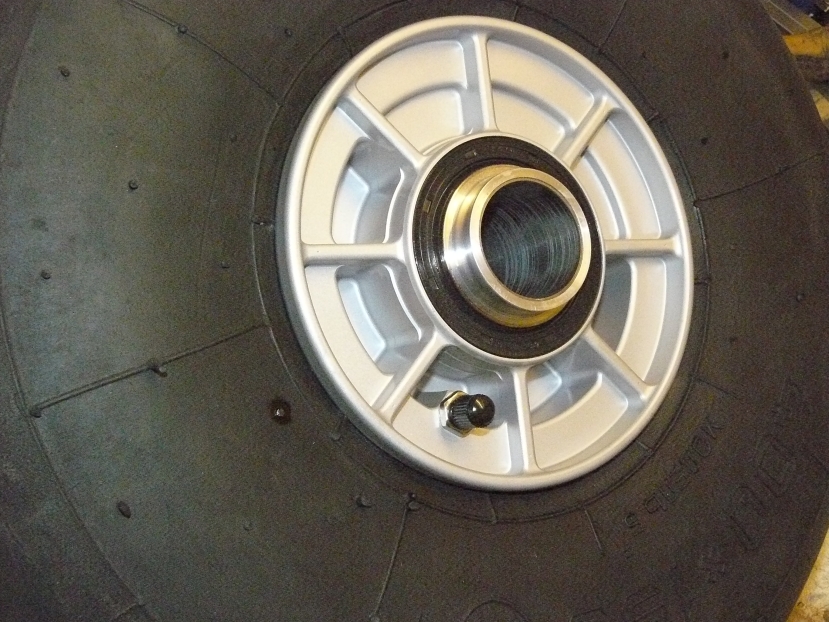

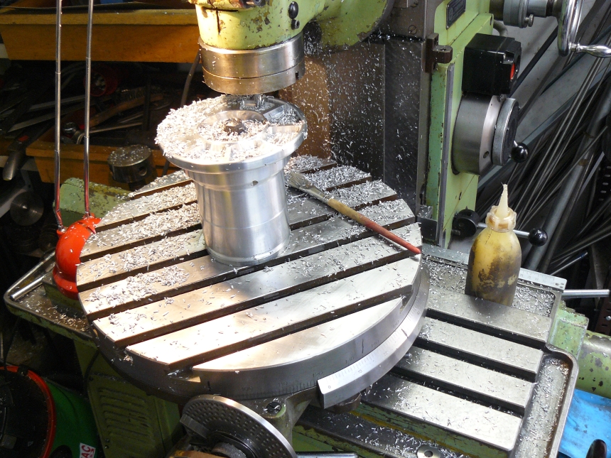

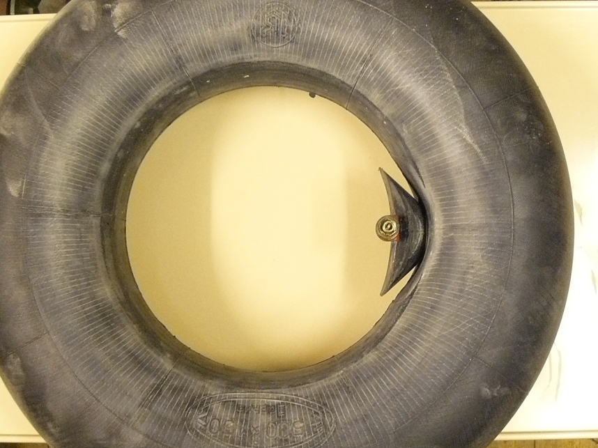

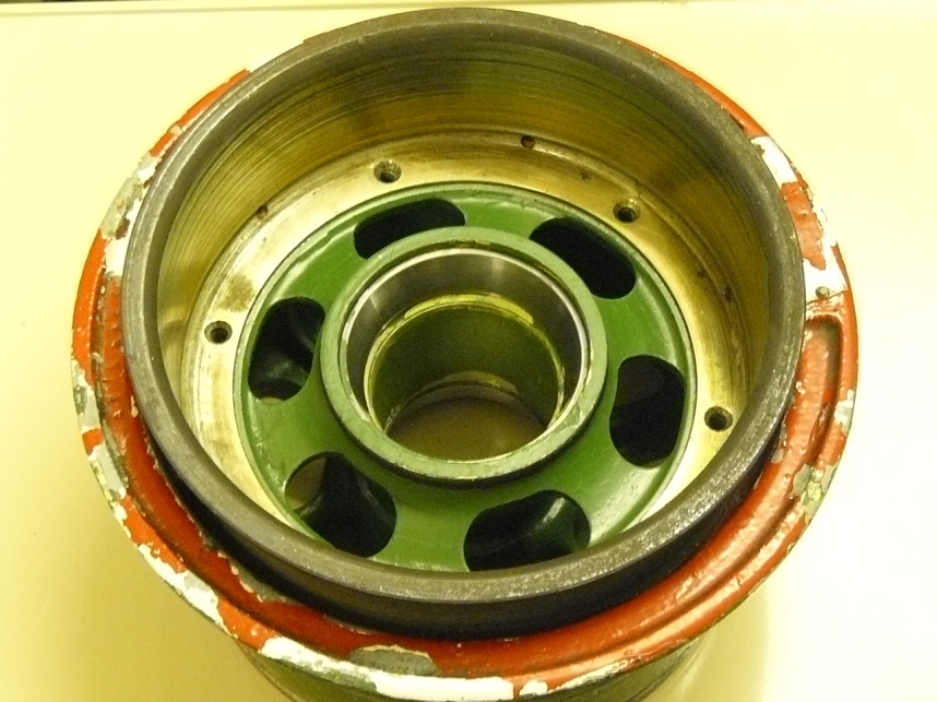

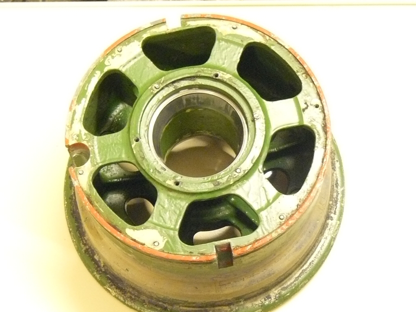

Hello,
Desser is most likely not to blame for wheel vibration, because a lot of vibration is caused by the valve and protecting rubber block of the inner tube. This assembly accounts for ~120 gramm unbalance. Plus, the rims on our 18 T are eccentric to the bearings, about 1.5mm on the indicator for the nose wheel. So you may be lucky to compensate eccentricity of the rim by moving the tire around a few times, but you´d have to balance the weight of the valve and rubber as well - not easy for the nose wheel. So I made a new nose wheel rim in aluminium with modern seals, preset taper roller bearings, and near enough balanced by inserting carbide from end mill shafts into the rim opposite the valve. For the main wheels you could put modern car lead weights with sticky tape into the wheel to balance it.
Vic

G'Day Vic,
Are you selling these rims and if sop how much?
I presume that you are using a tyre other than a Desser
Cheers,
Chris.
alikatz(at)mbay.net
PostPosted: Sun Nov 21, 2010 10:06 pm    Post subject: Nosewheel Dresser or Chinese/Russian? Reply with quote
Vic,
Very nice job on the nose wheel rim...
Jim

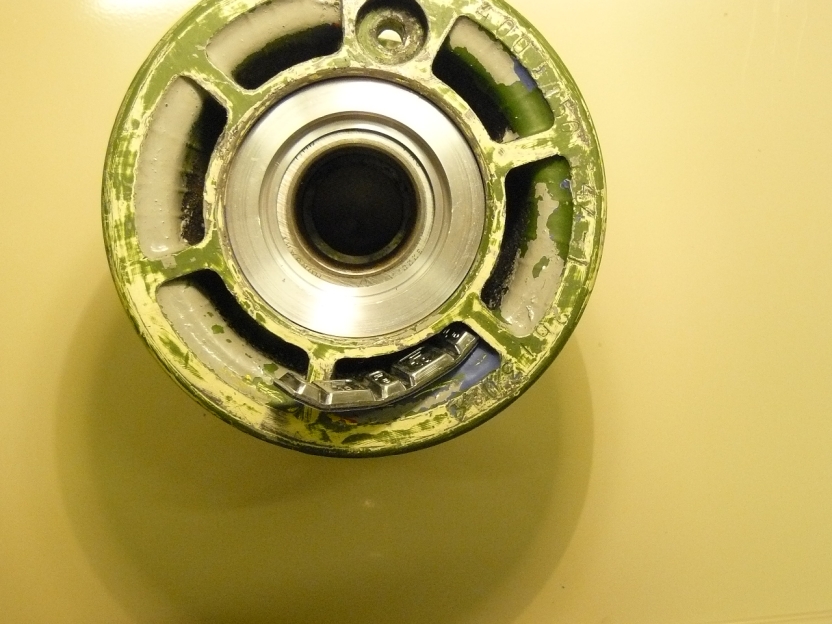

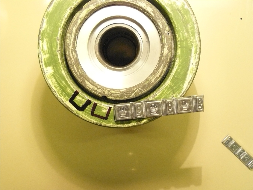

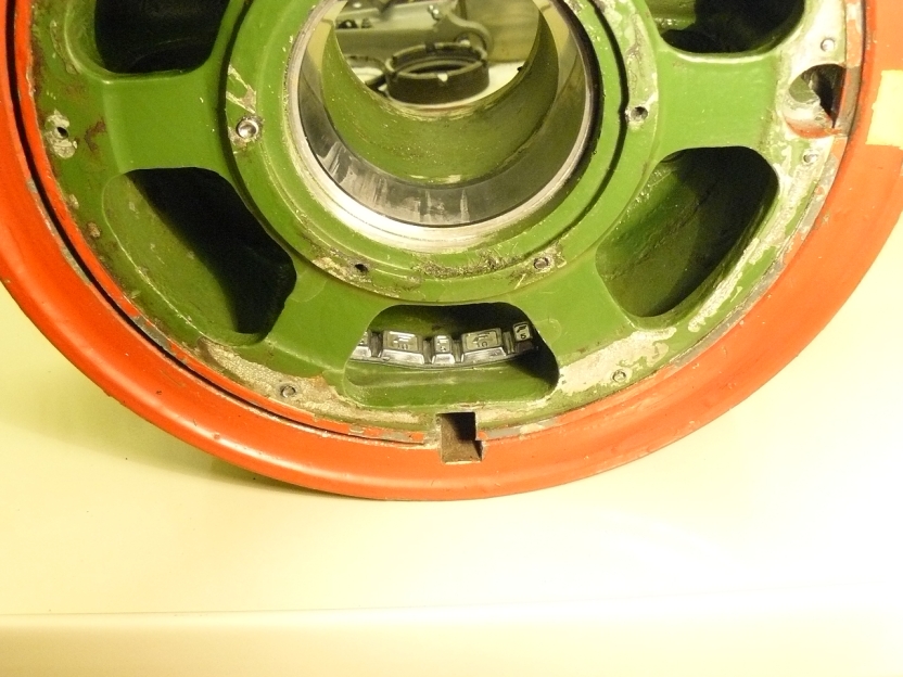

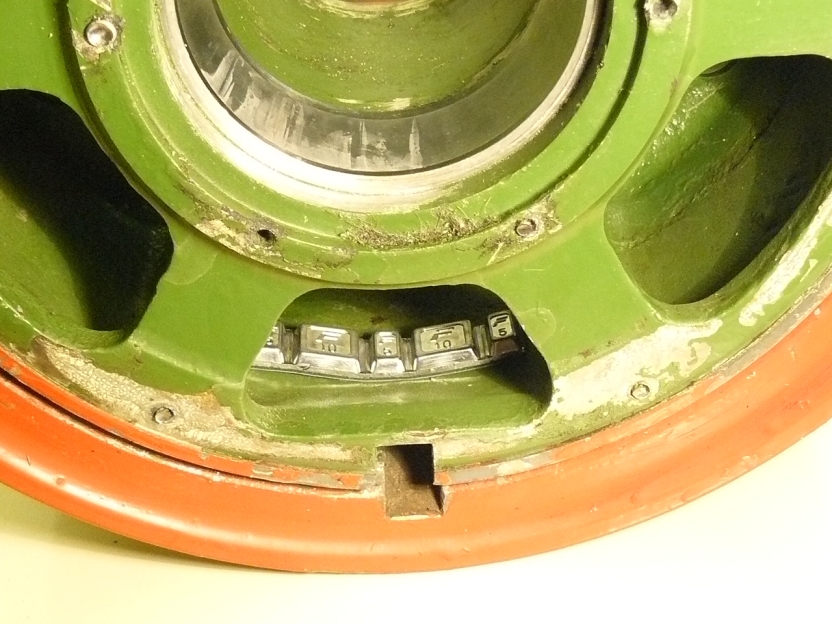

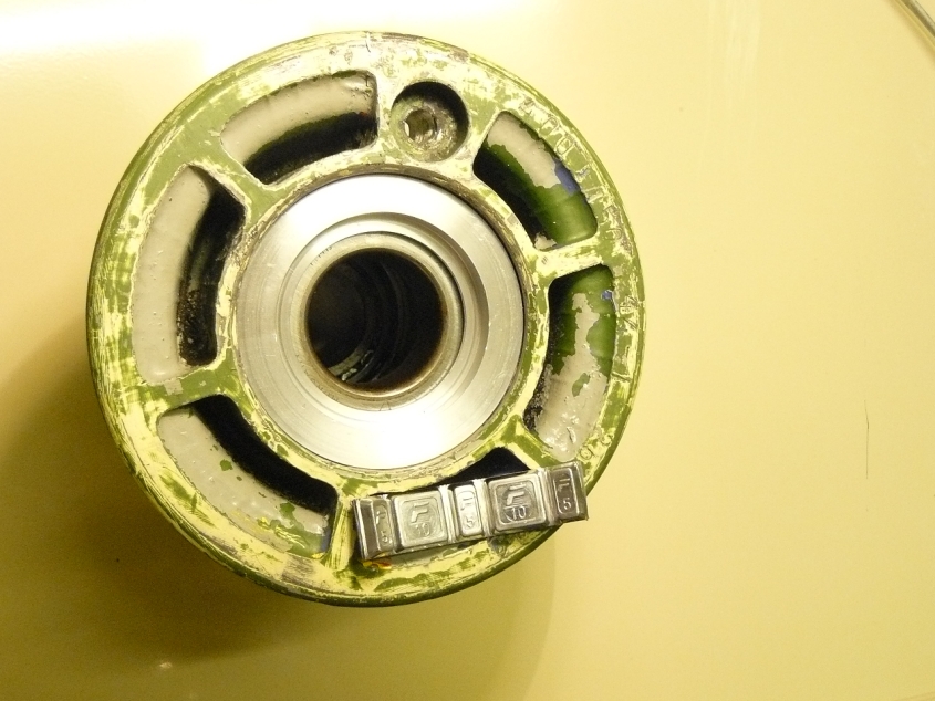

Hello,
thank you for asking, but there are no alu nose wheels for sale at present, maybe when I retire in two years ... Actually this was a very traditional (= time consuming) manufacturing process for a one-off, to replace a corroded magnesium rim . With a little help from CNC machinery one could possibly produce this at reasonable costs and achieve a superior replacement. This should give the shimmy damper an easy life then. So my idea in case of vibration problems would be to add some lead weights into the originals and have them balanced statically at least, a friendly motorbike shop should be helpful at that. The nose wheel offers only limited range of balancing, see photos. Maybe milling little pockets in the side of the separate flange to fight centrifugal forces for the weights should give reliable positioning combined with the sticky tape. For the main wheels there is ample space inside the cast wheel to balance. The geometric run-out of the rim is not so noticeable vibration-wise, I believe and you have to live with that. But I am working on a mod for modern seals ...
As to Desser tires, none required at present, WLAC in UK supply Chinese tires - no idea if they are a good alternative. But shipping from USA to Europe is cost-prohibitive for us on this side of the Atlantic. Am I right in thinking that tires and wheels of 18 T and 52 are the same ?
When producing replacements : Is there a legal aspect for the manufacturer like with certified aircraft ? Or in case of experimentals the owner is tinkering at his own risk ? I guess the pilot is in jail with one leg anyway.
