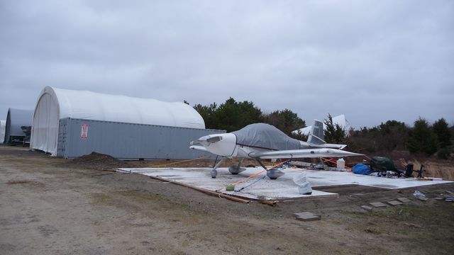

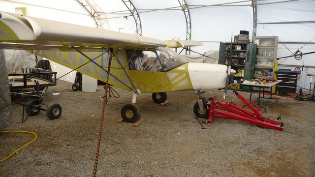

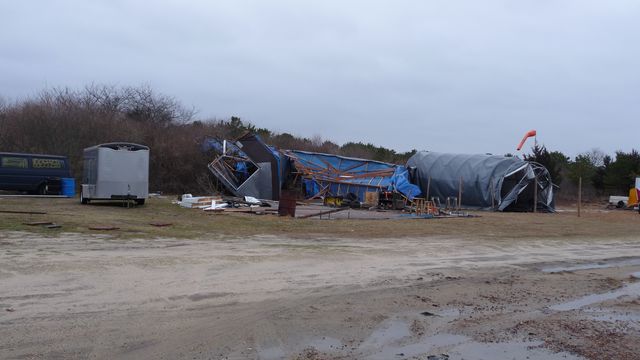

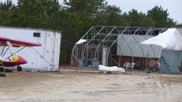

Hey Geoff,
I bought a tent hangar last year that was already installed at spadaro airport for 5k in marginal shape.
It was not used for a while, it looked more like a greenhouse inside. With some cleanup it has worked out very well.
On March 12 of this year we had a Noreaster with sustained winds of 75-80 mph gusting through out the night.
I had gotten a call that the door was breaking loose and had to spend the night out there saving my airplane.
The wind was hitting the door direct on.
The wind had pulled the 6 cement anchors out of the ground and were dangling from the bottom of the door by
the ratchet straps. We tied the bottom of the door to a box truck, and that saved the structure.
The hangar next to me was blown 250 away and it had a generator chained to the structure.
This hangar was just sitting on some wood. If you want your hangar to survive, the sides the length of the structure
will have to have a poured foundation. Also there are flaps on the bottom that should not be weighted or fastened
down. These are key to its high wind rating. On my door I used cardboard tubes(6) and poured cement into them
with anchors on top. When I installed the tubes I had dug holes, put the tubes in and backfilled around them. This
was a big mistake. When the door blew the smooth tubes around the disturbed dirt pulled right out.
I redid each one by digging bell shaped holes 3 feet down and poured in 4 80 lb bags each. We've had some bad storms
since and they haven't budged. Here are some photos( the next morning) of what could happen if you don't use cement down the sides and
solid cement with anchors to hold the door down. Loose the door, u loose the building. That night I tied the airplane
to anything I could, the nose to my engine hoist, the wing to the trailer. Also the RV was not tied down in the tent, it just
pivoted into the wind and stayed put.The tent and structure can be seen in the background.
The wind was still howling in the morning so we did what we could to secure it.
Brian
