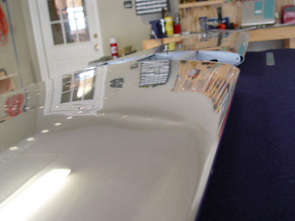

Was wondering if anyone else had this problem and if there are suggestions on how to fix it?
The nose ribs of the horizontal stab pull the skins in slightly and produce a dent in the skins on the rivet line.
This is only happening on the top side of the skins not the bottom and only to the nose ribs.
I have measured the worst looking one and it pulls the skin inward about 1/8 of an inch.  I’m confident that
this is cosmetic only however it is still upsetting.
Will I be able to fill this in with Superfill before painting?
Has anyone else seen this?
I could e-mail pictures if needed.
Thanks for the help.

PostPosted: Thu May 04, 2006 3:07 pm    Post subject: Dents in HS Skin Reply with quote
Guess I didn't make myself clear enough in the first post. It
wasn't caused by not trimming the nose of the rib but rather
it is pulling the skin down on the top of the HS almost like the
rib was not tall enough.
I've attached a picture for all to see.
Marc

PostPosted: Thu May 04, 2006 4:48 pm    Post subject: Dents in HS Skin Reply with quote
That's very normal, I think. There isn't a crease, is there? I think it
might be possible to get the bend on the non-ribbed portion of the skin a
little tighter, but I wouldn't mess with it.
Do not archive.
Jesse Saint

PostPosted: Fri May 05, 2006 5:35 am    Post subject: Dents in HS Skin Reply with quote
Marc,
This is typical of all the RV-10's I have seen, except I have only seen 4. I quit worrying about it after I looked at both of Van's RV-10's. Mine and Bob Kayfmann's here in Las Vegas are just like that. Only thing you want to make sure of is that the flanges on the rib fully contact the skin and that you made sure the flanges were 90 degrees from the web of the rib itself. The other posts addressed the problem of the leading edge of the rib causing the skin to crease at the rib, you don't seem to have that problem. Bright shiney aluminum tends to acentuate any minor deviations from absolute flat. I borrowed a pic from Mike Howe's site where his stab is hanging on the wall and you can easily see the same thing. Drive on!! you got lots more to do!
Rick S.

PostPosted: Fri May 05, 2006 10:17 pm    Post subject: Dents in HS Skin Reply with quote
If you go back and read my original post along with some of the things
others have said it should make sense why this happens. Rick's post from
today is the bottom line.
You might see this again when you make the elevator trim tabs.
Think about this, in the case of the Horizontal stab it is the leading edge
bend and the nose rib shape.
With the elevator trim parts you bend the aluminum in a bender and if you do
not make the trailing edge bend tight enough, when you go to glue the foam
ribs in place you will be squeezing the metal skin in to the ribs more than
the non rib supported skin wants to be so in the end you might see a
depression where the ribs are sucking in the skin.
My epoxy worked better by allowing the H.S. skin L.E. bend dictatethe shape
of the airfoil in conjunction with the ribs and spars. Any gap between the
inside skin and the rib flange was filled with epoxy, that is why I
rechecked the rivet lengths. This even with the rib flanges 90 degrees to
the web.
Bottom line, it is good you are seeing the issue and thinking about why it
happens.
John G.
Marc
