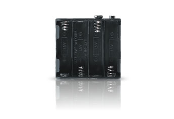

Get a Radio Shack AA battery holder for 8
cells (Catalog #: 270-387)
[img]cid:.0[/img]
An populate with fresh AA cells. Measure
the terminal voltage on the holder. If your
meter reads 12.8 volts, it's close enough
for government work. If it's something else,
make note of that difference. Let's say it's
12.5 volts. Okay, any reading in that range
is 0.3 volts high.
Now, go measure the bus on your airplane.
Apply any observed calibration offset to the
reading and THAT becomes your benchmark for
evaluating the veracity of the other displays
in the airplane.
