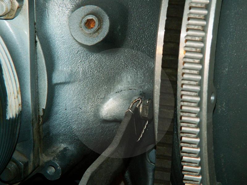

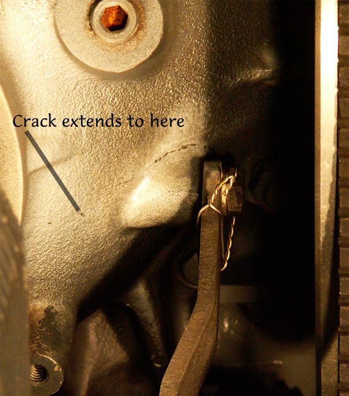

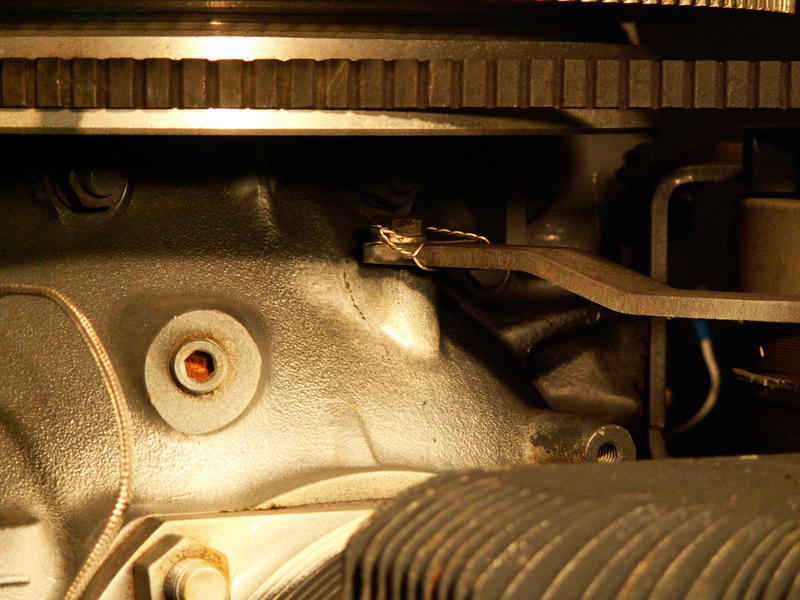

Fast forward 2 years and 175 hours. Compressions were low 40s on 2 cylinders and the other two were mid 60s. "It still feels like it's flying fine." she would tell me. "The guys in Pali, (her vernacular for Palo Alto) told me I must have stuck rings. They said I should soak the cylinders in Mouse Milk and then (some other solvent I can't remember)."
So, for 2 weeks, I kept they cylinders full and pulled the engine through a full four cycles everyday. Then refilled, repeated, then refilled. What the hell, I charged her an hour a day for 2 weeks. It was her choice. I just couldn't convince her that the engine did not really get a real overhaul. She kept insisting, "It only has 300 hours since major overhaul!"
After 2 weeks, there was no change in the compressions. I ran the engine and high speed taxied it for an hour. Checked again. No change. (oh, by-the-way, these were the instructions the guys in Palo Alto wanted me to follow. It was her money.)
I pulled the cylinders to send them to LyCon. The block was cracked at the alternator mounting boss. Over the last year, when she brought it in for an oil change, I thought there was a lot of oil. (I had changed the #4 oil drain back tube the oil change prior because it was corroded through and leaking a lot. I thought that was the source of the oil).
When I called her and told her that her engine block was cracked she responded with, "How can that be? It only has 300 hours since major overhaul." I got her a deal on an overhauled engine directly from Lycoming for under $19,000. Her response, "The guys in Pali said I can have the block welded for a couple of hundred dollars." So, I put her plane back together and sent her on her way.
A year later she flew to Auburn for a fly-in. I asked about the engine. Turns out, during the tear down to get at the crack, they found bent rods, a bad cam, bad lifters, and the crank was scored. Oh, yea, all of the cylinders were so badly cracked they couldn't be repaired. Putting the engine back together cost her . . . . . drum roll . . . . $19,000. And 6 months.
When she called for an annual, I had to reply with, "I would love to work on your plane but, I'm not the right mechanic for you. Have the guys in Pali work on your plane."
Bottom line: You get what you pay for.

Barry, I don't know why you have such a hard-on for Lycoming cylinders, they are much better cylinders.  No ADs to start with.  I've talked to Ken at Lycon about the various cylinders.  From his perspective, they are the best and they make the most power.  Building 500 engines a year, including racers and air show planes, he should know.  You can pay less for a cylinder, but that's what you'll get: less.
Since the labor costs the same to remove and replace a $200 overhauled cylinder as it does to replace an $1100 new cylinder, the only advantage is, you won't have to replace the new cylinder in a hundred hours.
Oh, good, I feel a story coming on . . . .
A few years back, I had a customer with a new, to her, 1976 Tiger.  Her primary reason for picking this plane was that it had an overhauled engine.  Yep, only 125 hours since complete overhaul.  The compressions were in the low to mid 70s.  It leaked oil at the case parting line.  And, in flight, it felt very weak.

PostPosted: Tue Nov 09, 2010 10:36 am    Post subject: Cylinder woes Reply with quote
Well, Barry,
What are we talking about here? Gears? or Cylinders?
As for the gears, how many out right failures where there? Not many. For the most part, the bottom end of any Lycoming engine will run seemingly forever with a bad cam, bent rods, and a crank that needs to be turned. IF the engine has been taken care of regarding oil changes and regular use, the bottom end is good for 4000 hours.
Rockers: Here, I'd have to agree 100%. Two nearly identical rockers with no stamping showing how they go in. In 1984, I was doing a very thorough annual on my first Cheetah. The engine had 600 hours on it since new. The rocker cover gaskets were leaking, so, I decided to change them. In the process, with a brand new Lycoming overhaul manual in hand, I decided to do a dry tappet clearance check, just for shits-n-grins. Inside the maintenance hangar, about 20 yards from the main FBO, I started carefully removing all the parts. On the work bench, I laid out everything in the order I removed them. During the cleaning process, I noticed a there was a difference between the rockers. Strange this was, from the factory, one side of the engine was one way, the other side was different. I asked the mechanic there, Jack, a guy who had been working on planes for some 30 years, which was which. He said, and I quote, "I don't know. I've never noticed a difference before." I called Lycoming and talked to an engineer. He didn't know either. Several transfers later, I got an answer.
Do you know the logic behind the different rockers? The squirter is supposed to squirt oil on the valve stem . . . exhaust only to help cool the valve. The other one is supposed to dribble oil onto the rocker . . . . intake only. These engines have no oil seal on the valve stems. Squirting oil on the intake only makes oil go into the intake port, coat the inside with residue, and burn more oil.
Waiting for more oil to be delivered to the heads: This is a major misconception. Born, in part, by Bill Scott and Bill Marvel. Sodium filled valves were first used almost 100 years ago. By the mid 30's there was a lot of research being done on sodium filled valves. Why? Because, at the time, rockers were out in the open. Sodium filled valves offered a way to shed heat without much oil. In fact, research done by Samuel Heron in the late teens, early 20s, showed that excess oil on the valve causes valve sticking. And, if you think that sticking valves are unique to Lycomings, you haven't kept up on the valve problems (using solid valves and lots of oil) in Continental engines. Do a little research regarding oil on sodium filled valves. The problem is really due to the geometry of the rocker/valve stem during operation. The side loads on the valve cause the guide to be worn excessively*. This is true of ALL engines without roller rockers. In this respect, the solid lifter engines (i.e., O235) are better. Ideally, you want to get roller rockers to get rid of the side loads. Hot Rod magazine had an excellent article on valve geometry not long ago.
* this is THE reason why I recommend a top overhaul with new cylinders at 1000 hrs. I've pulled a lot of cylinders with 1000 to 1500 hours on them. I send them to Ken for tear down and inspection. I pay for the research on this one. In every case, the cylinders have cracks in the exhaust port. Most, but not all, show excess wear in the guides. The ones that don't show no correlation between them. (that is, without getting Charlie Epps to do a math analysis of it.) It just isn't worth patching the cylinder to get another 1000 hours out of it. It'll never make it.
Fins on Superior engines: Now, I ask, was that a work of art or what? Really pretty weren't they. Problem was, those machined heads (in place of cast heads) gave up 30% of the surface area needed to shed heat.
Casting flashings: I ground out the flashings on about a half dozen engines. All with JPI engine analyzers. No change. Sloppy workmanship, for sure, but not critical. The new heads are a whole lot better.
I feel you can learn many things from stories. I also enjoy your stories.
--- Thanks
My first thought was WHO did the overhaul?
--- It was done by an FBO in New Jersey
My second thought was: She is fixating on the numbers and not the situation. Everyone would like a quick - cheep cure to low compression.
--- She is a lawyer. What can I say?
And I have to ask... Sorry Gary... Why did the block crack?
--- My guess is the crack was there from the beginning (well, before I got it). Ken told me this is usually due to the alternator bracket on the bottom of the engine breaking and the alternator hanging on the upper brace. The boss the upper brace is attached to, breaks.
I'm twisting the knife here and it is NOT fair. A cracked block is far from normal and not something that can be blamed on Lycoming. And if the crank was scored there must have been quite a bit of heat. Maybe before she purchased the plane and as you said: " I just couldn't convince her that the engine did not really get a real overhaul."
And I agree, you do get what you pay for. But you should not have to pay too much.
When it comes to repairing a problem, I say it a little differently: "Pay me now, or pay me later; the problem is not going to go away."
--- She paid way too much for the plane. It was full of corrosion. Under the instrument panel was a nightmare. Someone had wired in an audio panel, one wire at a time. There were wires everywhere.
[b] --- Side note: same plane. During the first annual, I noticed a dent in the bottom of the right wing. It looked like the wheel pant had dented the wing. Now, to my way of thinking, this is impossible. Upon further investigation, the four 3/8 inch bolts holding the axle onto the fiberglass gear leg were bent. The gear leg was splintered.
[b] --- Continued: Before she came to me, she bought a LoPresti nose bowl because the engine 'ran' hot. The JPI shows it anyway. After installation of the LoPresti nose bowl, it ran even hotter. This was my first LoPresti nose bowl. Turns out, you can't tuck the baffles into the top of the nose bowl inlet and form a tight seal. You really need to know what you're doing to properly seal the LoPresti nose bowl. 99% of the 75,000 mechanics out there haven't a fucking clue how to properly install baffles. That leaves 750 t[b][b][b][b][b]h

PostPosted: Tue Nov 09, 2010 4:14 pm    Post subject: Cylinder woes Reply with quote
WOW ! ! !
Gary,
That crack is impressive.
A dirty engine would surely hide that very easily.
