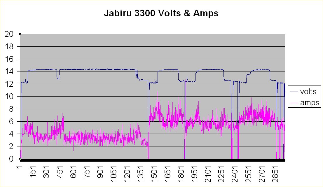

PostPosted: Mon Nov 01, 2010 3:06 am    Post subject: Re: Amp Meter Reply with quote
My Jabiru/Dynon D180 shunt is on the primary feed wire right before the main bus. This makes it is a load meter with a 0-20 amp type reading. Looking at the attached plot in the short term (point-to-point), shows about a +/- 2 amp variation or noise in amperage. I don't know what other aircraft ammeter plots look like, but I consider this an acceptable amount of variation for my aircraft. As has already been asked, where in the electrical circuit is your shunt? I assume it is in one of the three locations suggested in the Dynon install manual.
Good luck,

PostPosted: Mon Nov 01, 2010 4:55 am    Post subject: Amp Meter Reply with quote
David:
Your terminology is a bit askew.
A LOAD meter is a device that calculates the Voltage and the Amperage and gives a Wattage.  YET!  I have seen the wattage terminology left off and Amps substituted.
Putting an ammeter in series with the battery will show the amperage/current flowing to or from the the battery.  Your 0 - 20 Amp meter will show ONLY current going to the Buss.  You require two conditions to show + & - current:
1 - A meter with the capability of displaying + & - current (Zero Center Meter - Analog or a Digital - Circuit to do the sensing) and
2 - The output from the alternator to be BEFORE the Amp Meter.
That way it will show current going TO the Battery - Charge State.  Or FROM the Battery - Discharge State.
I missed the "plot" you are referring to ... Did you or someone graph a charge - discharge condition?  What is this "noise" you are referring to, is that your terminology?  I have never heard of amperage referred to as noise? Voltage, YES!
But, I get the feeling that you are referring to the Idle State of your electrical system.  What it requires without any additional components turned on.  Just the state of Master Contactor closed & Alternator charging, am I close?

PostPosted: Mon Nov 01, 2010 8:35 am    Post subject: Re: Amp Meter Reply with quote
Barry,
Not being an electrical expert, I can only aspire to try and correctly interpret terminology from those who are. An example being from Bob Nuckolls Aeroelectric Digest "Loadmeters only read 0 to some value either in amps full scale (or in the case of the ones I sell, 0-100% of alternator output)." That is about as deep as I can describe a loadmeter.
Terminology aside, my configuration of metering the load is that I only show the + amperage going to my aircraft loads. As opposed to two other shunt locations that would show (1) +- flow in and out of the battery or (2) + only, but going to both aircraft loads and the battery.
