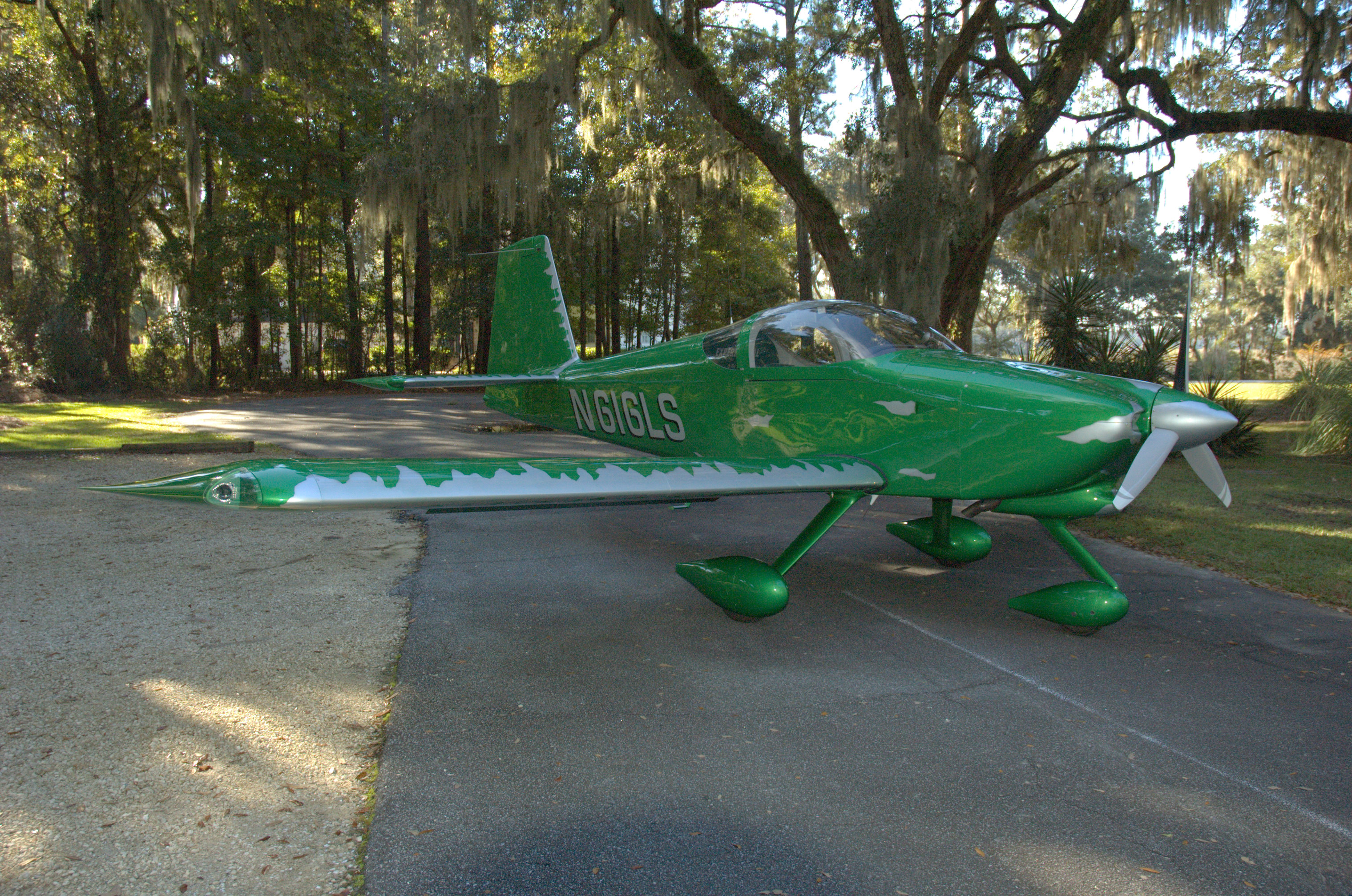

Hmm, I wonder what is different. I am 6 feet tall and flew with a friend today who is six feet one and had the booster cushion on his side under the comfort aero seats and he also had plenty of head room.
Mine has a 160 hp Superior engine with a 3 blade Cato prop and at WOT it will turn 2800 rpm and 170 kts. I normally cruise at 8500 ft and 2350 rpm leaned 25 degrees LOP and burn 5.8 gph at 135 kts.
The tip up has much better access to the avionics.

 Filesize:  2.04 MB
 Viewed:  14455 Time(s)
