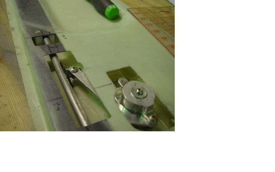

Has anyone else retrofitted their flush doors to use Plane Around latches?
My door have iflyrv flush door handles already installed... and working.
I'd like to incorporate Plane Around center latches to get the doors to positively close every time: http://www.planearound.com/
The attached photo shows the back side of the flush handle workings. The aft push tube would appear to constrain extra throw as the linkage arm will limit its movement.
That is, the total range of push tube motion will have to be the same - before and after adding the Plane Around center latch mechanism. This would seem to rule out use of the 180 degree retro kit.
What have others done here? Would a 90 degree motion of the Plane Around center latch be sufficient?

Hi Jay
I have recently installed Sean's latches. I had bought retrofit racks hoping I could use the extra throw. As it turns out, in my case at least, the Iflyrv10 latches are the limiting factor.
The 90 degree retrofit kit works quite well for me. 90 degrees gives the CAM a log of grip on the door sill.
Cheers
Les
