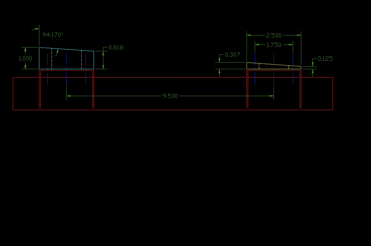

Thom, Ted, all, I went out to the hangar and measured up the Mk III and Firestar engine mounts to get some input for Autocad. I measure both at 9.5" between bolt centers fore to aft. Since I have to have a little material to hang on to while fly cutting the face of the shims I set thickness of the forward edge of the front shim at .125". Using Ted's suggestion that .875" (7/8") is the best height to correct the thrust line, I put the aft edge of the aft shim at 1.00". Connect the two lines and measure the angle and out pops 4 degrees on the button. Thom, based on your measure that your thrust line is currently 3.5 degrees up, shims based on these numbers would put your thrust line down (converging with the bottom of the wing by .5 degrees.

Thom, The pads are a bit over 2.5" fore to aft. The distance between mounting holes is 1.75" (taken from a spare mount). I can get 2 1/2" wide bar stock at a local supplier in both 1" and 1/4" thick. The smaller size for the front wil I figure I'll put a 1.375 hole in the middle of the shims just to take a little weight out of them. I picked the size only because I have a cut down drill of that size that has the shank ground to 3/4" so I can run it right out of a collet and it is short enough that I don't have to get all aerobic cranking the table up and down. I went back and dimensioned the drawing so you can compare to your mount just to be sure. Turns out I had the accuracy turned down a bit to much on angular measurements when I said it is spot on at 4 degrees, but I doubt that little extra will make a big difference.
Rick

Rick, don't forget to make 4 thin beveled shims for the under side of the engine mounts. (6 thin & 2 thick total).
Otherwise you will be bending the bolts.
