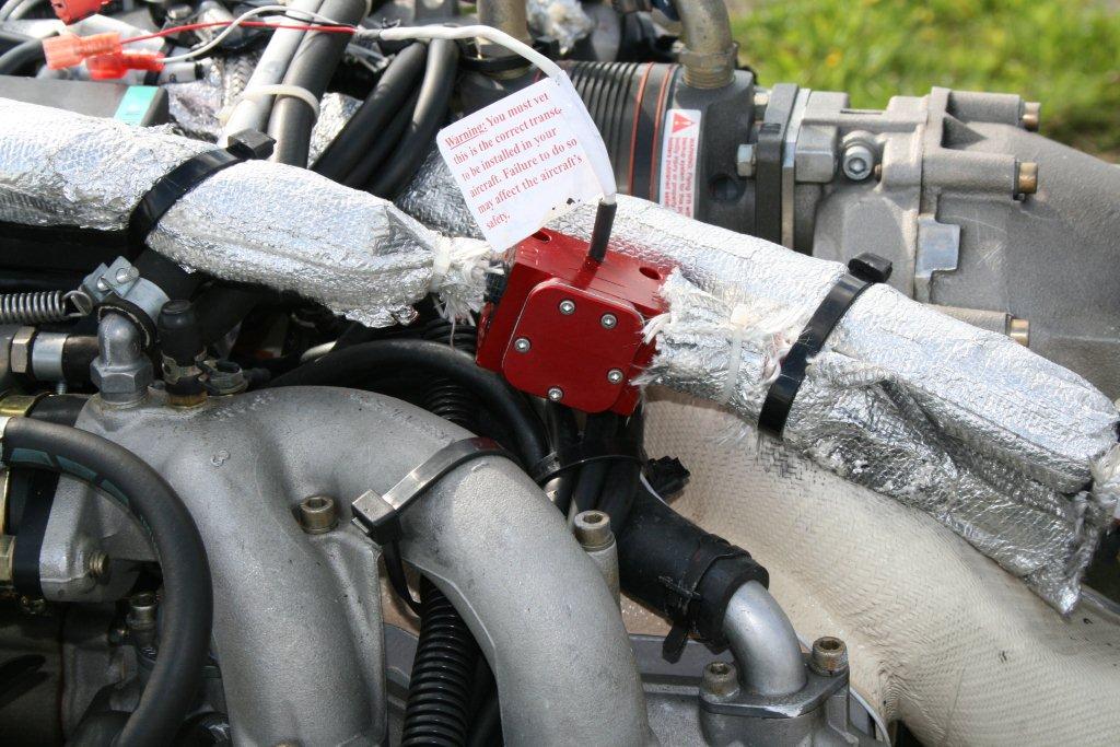

In my earlier posting today I wrote:
"I placed one transducer between the engine driven fuel pump and
the right side carb,--"
I actually placed the transducer between the engine driven pump and the
branch-off to the right side carb - it must of course measure the total flow
from the pump to both carbs - see attached photo.
Svein
LN-SKJ
