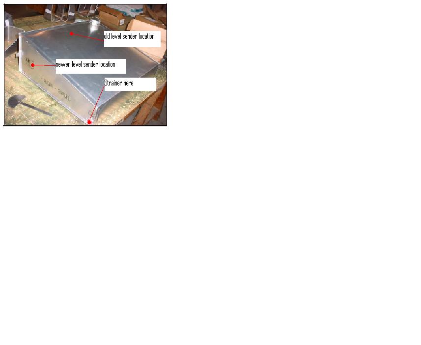

See attached photo of right side tank, as viewed from cabin.
Kevin

Ross, the fuel pickup in the tank is essentially a pipe thread bung welded to the sidewall of the tank near the bottom back corner. Standard proceedure is to thread a finger screen into this bung and then the barb fitting threads into the finger screen. If there is a finger screen in place (two inch long cylinder of metal screen) then the incident you are decribing should not have affected your fuel flow.
I don't remember if the 701 plans show the installation of a finger screen or not but I know the 750 does since I'm helping to build one of those now. If your plane doesn't have finger screens it would be a good idea to install them.

block strainer screen.
Normally looking in filler you will see clean aluminium walls & bottom of
tank
If it has been sealed you will probably need a new tank as I doubt you
will be able to clean it. possibly someone on list can advise.
Clive

OK . i borrowed an end on flexible scope. tank is clean and shiny inside. screen is good shape. removed gas-line to inner cabin filter blew out = no dirt, checked flow measured gal/min from both tanks and are equal both sides. fill cap was off at this point
then ame comes back to collect his scope. and points out a possible problem. i have covers on the forward curved vents to the gas caps when parked. these are removed preflight. but i didn't check to see the condition of these tubes. one has been pinched shut by some plyers what the f....
we had a lot of fuel stolen from the field last fall. a couple of weekends of stunt drivers on the grass at nights recently. now blatant tampering. easy fix but the preflights are very long now.
thanks for your help. I am thinking of doors for the hanger..odd that both things happen to come at the same time. kind of what put me off in the wrong dirrection.
