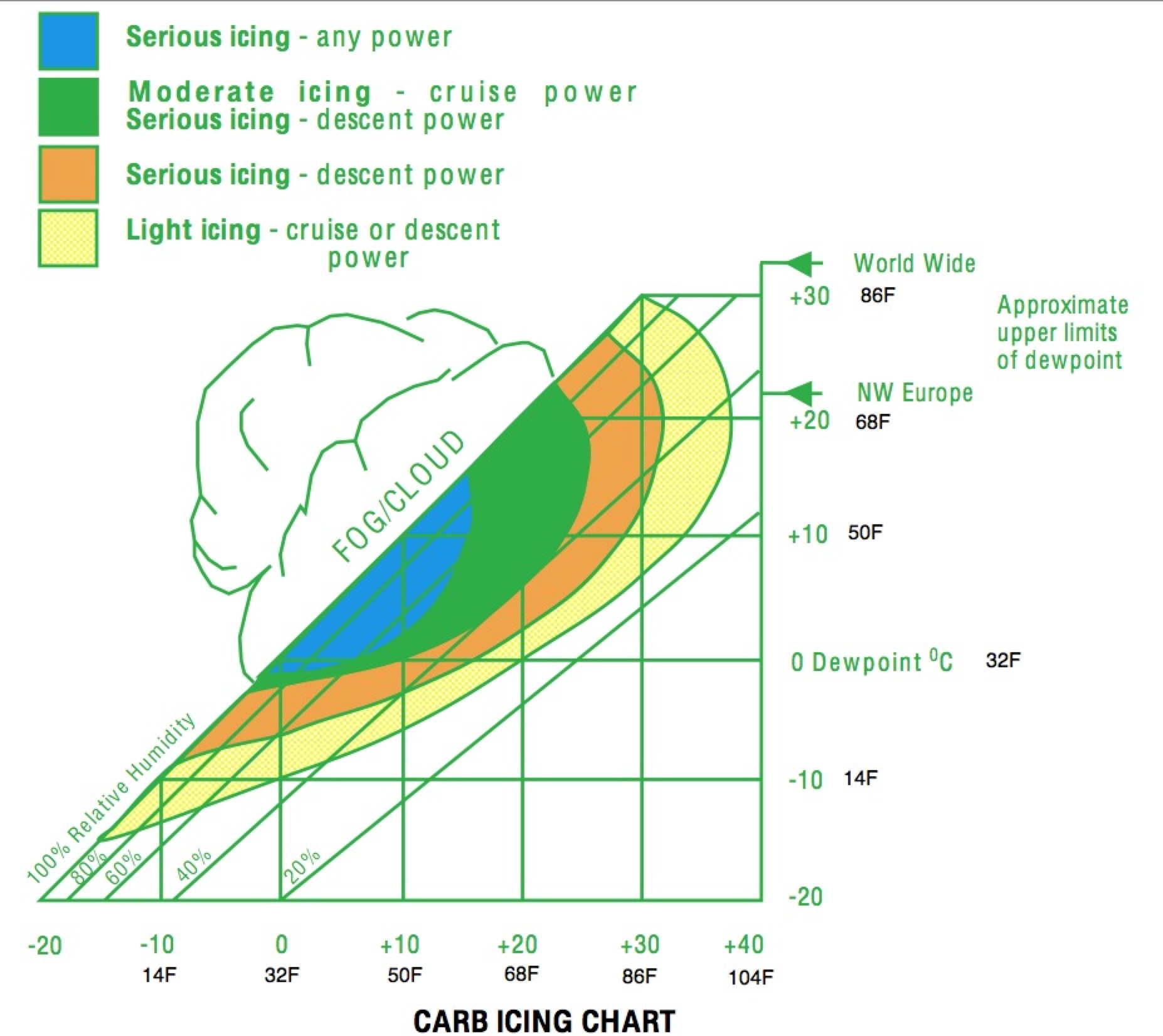

PostPosted: Wed Oct 13, 2010 5:37 am    Post subject: Re: engine failure at take off Reply with quote
Florida climate in the fall is more likely to cause carb ice than upstate New York this time of year. See image of carb icing conditions.
Carb Icing probability
 Filesize:  367.35 KB
 Viewed:  4528 Time(s)
