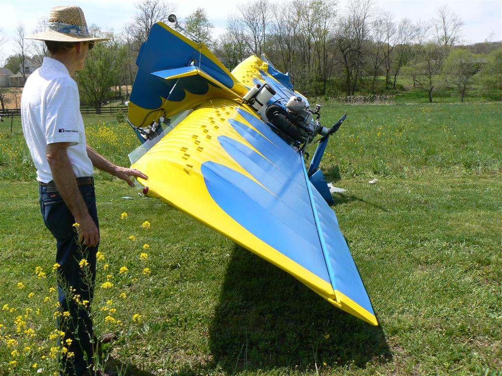

We are planning for the recertification of the two FSII's into one around Thanksgiving.
Richard Pike
MIII N420P (420ldPoops)
