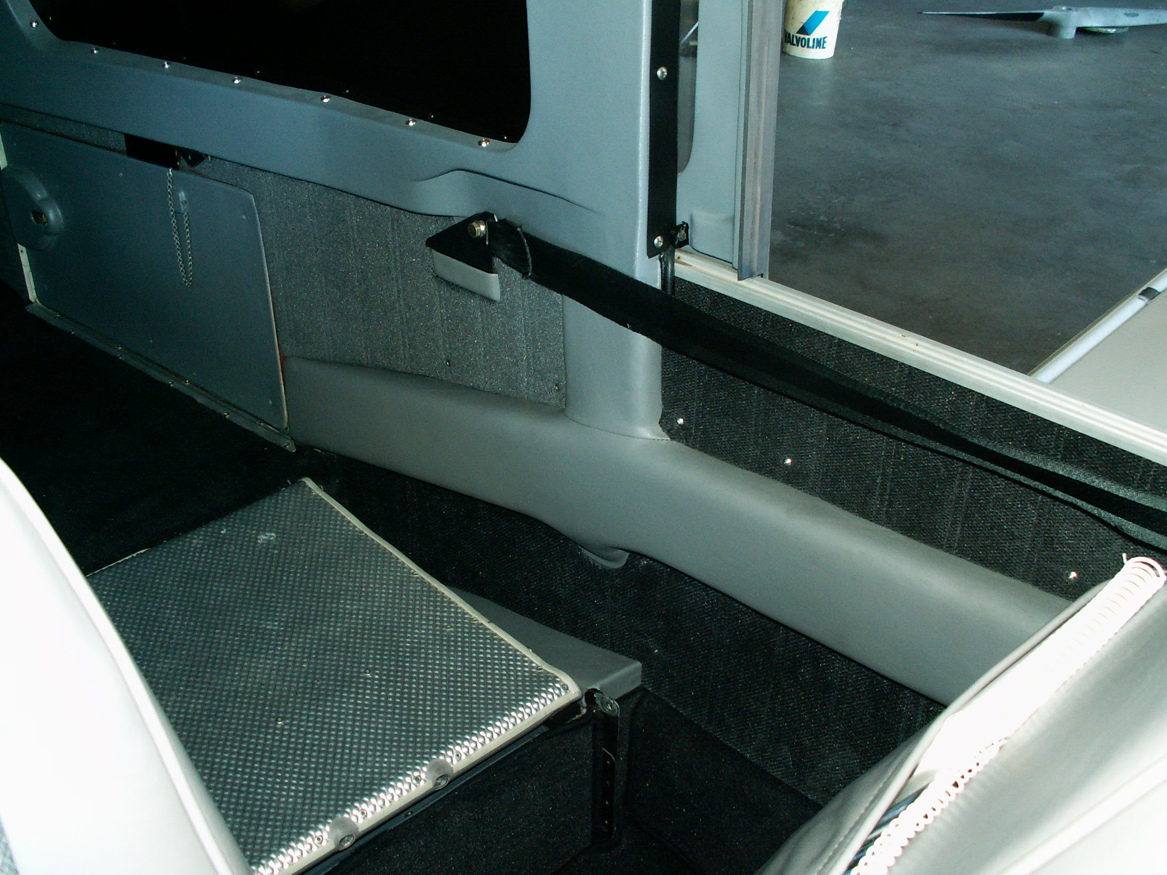

I've done both on my planes, looking for an optimal solution. Not so easy. In the latest iteration, the one I've used for the last 4 years, I use my fiberglass armrests (see pics) for the wiring. The way the side panels are installed, it makes maintenance (i.e., lazy avionics guys) easy to get to the wiring. When I installed an S-Tec 30, I used the pilots side armrest. I have Adel clamps that hold things all neat and orderly.

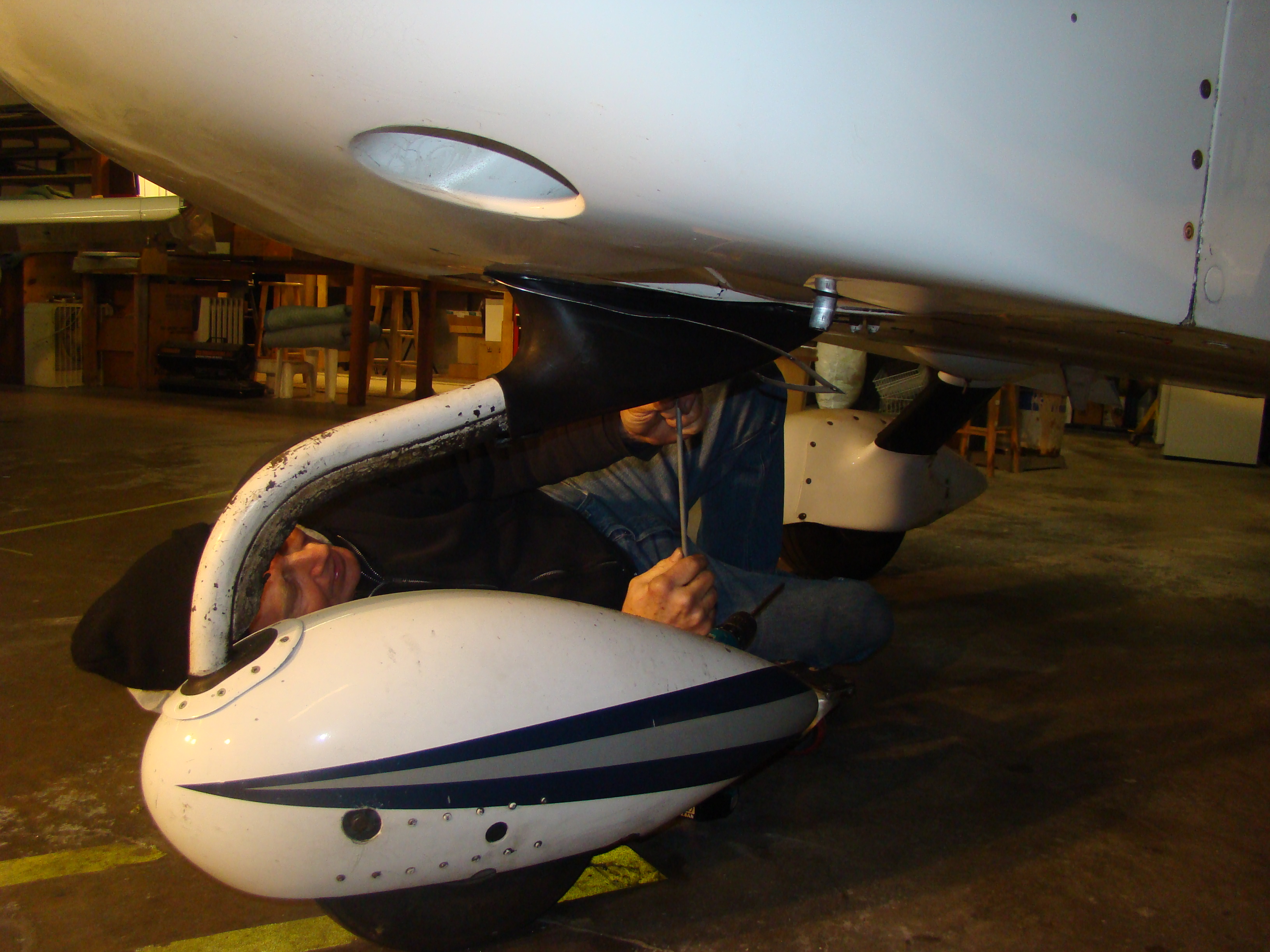

I found one. This is Larry's plane.

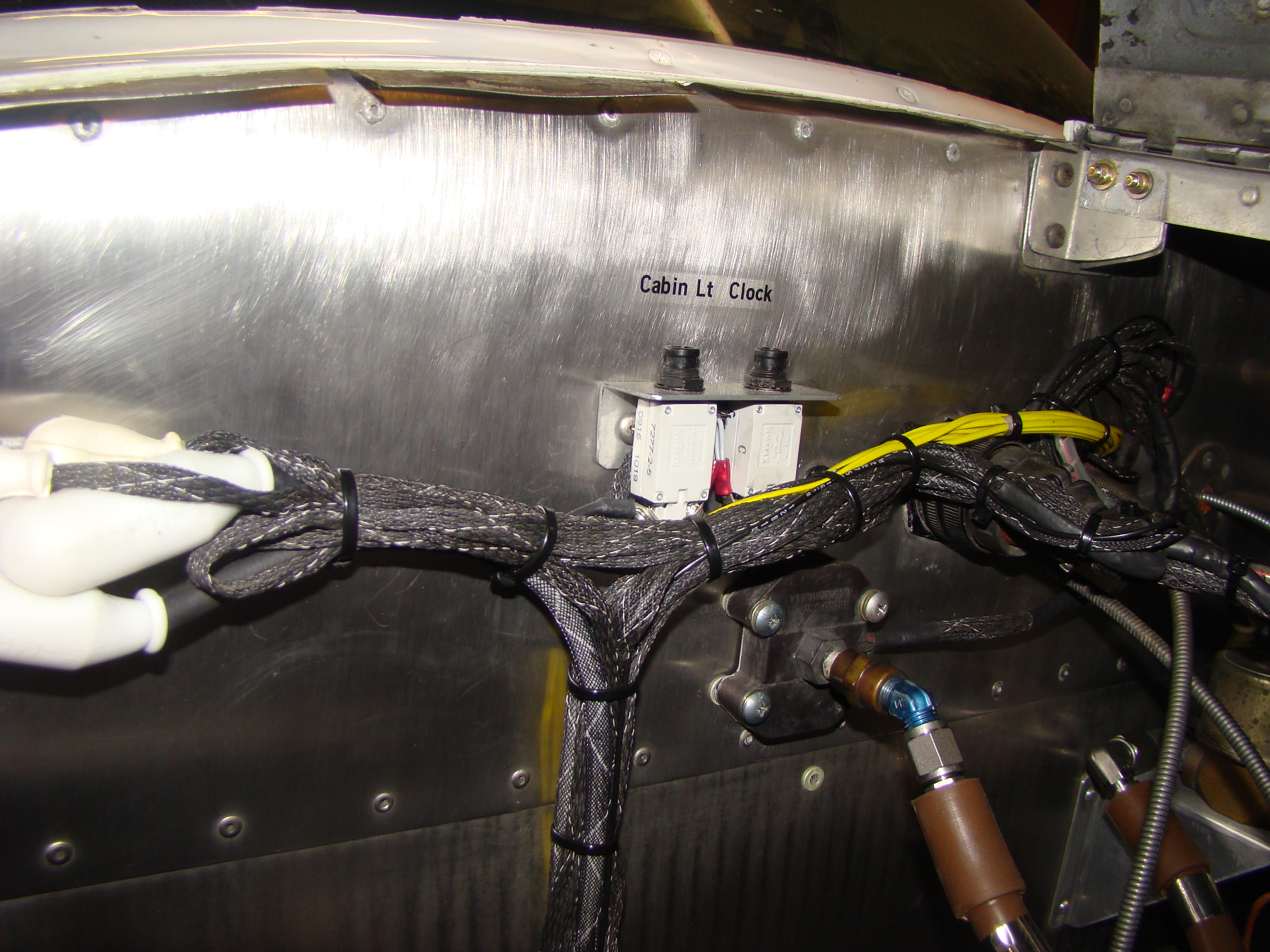

Kevin, if you're listening, here is a firewall on an AG. Move the shunt and it's a lot cleaner.

This is a late model AG5B pic of the shunt - it is mounted where the AA5B has the Voltage Regulator. The connections are now housed inside an enclosure to clean up the look. This particular plane has the G1000 so you may notice a couple of extra fuse holders (intentionally not hidden up under the panel) that are not on the earlier models.

the pic of the AG shunt had that box. Looks tacky. Looks like someone said, "Where should this shunt go?" "I dunno." came the reply. "How about here. This space isn't being used anymore." Never mind that there is no maintenance ever required on it and it takes away from an otherwise clean firewall. There is no reason that shunt needs to be there. I've installed a number of Mitchell gauges and the shunt mounts conveniently in a number of places under the panel.
