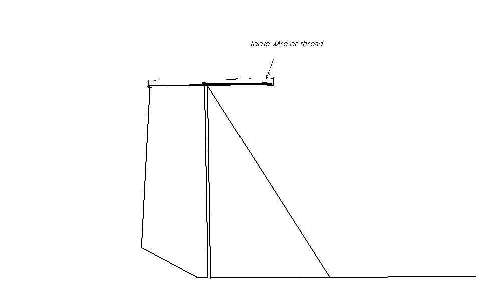

Here's the bird poop perch - what's odd is that I don't get much bird poop below it, but the left side of the horizontal stab constantly gets littered with some sort of little black droppings. Never have figured out exactly what sort of poop it is (I am trying not to get too proficient in that sort of thing) or why it is only at that one place. At least it doesn't stick, the prop blows it away.
http://www.bcchapel.org/pages/0003/pg6.htm
Richard Pike
MKIII N420P (420ldPoops)
mdnanwelch7(at)hotmail.co
PostPosted: Sat Sep 25, 2010 10:06 am    Post subject: Aileron flutter and Tail-wag Reply with quote
> Here's the bird poop perch - what's odd is that I don't get much bird poop below it, but the left side of the horizontal stab constantly gets littered with some sort of little black droppings. > Richard Pike
Bro. Richard,
  If you don't want any flying creatures landing on your rudder counterbalance arm, you
might consider building a little contraption I saw once.
  If you make a little device that suspends a couple of loose strings above the length of the
balance arm, birds can't quite land on it, so they pass it up.  Either loose wire or string
will do, maybe one or two strands is all you need.
  With a floppy string in the way, it interferes with the bird being able to get a grip on the
counterbalance arm.  Keep the string sort of close, maybe about 1/4 to 1/2" and the birds
can't wrap their feet around the string and the arm.
  You could probably throw something together in about 10 minutes.  You might consider
a clothes pins or weak finger clamps.  (see attached drawing for an idea of what
I'm getting at)
  Just a thought...
Mike Welch
