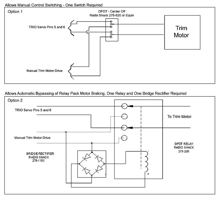

>no relays are needed and either set of trim switches can control without shorting<<
I'd be interested in seeing a schematic for two trim switches without a relay.  Are you using a selector switch for one stick or the other?
The installations I've seen without a relay or a selector switch would always pop the breaker if both tried to trim at the same time.
Dave Saylor
AirCrafters
140 Aviation Way
Watsonville, CA 95076
831-722-9141 Shop
831-750-0284 Cell
pitts_pilot(at)bellsouth.
PostPosted: Wed Sep 22, 2010 8:25 am    Post subject: performance (pitch trim) Reply with quote
The problem isn't dual sticks ..... it won't matter if the switches
are wired in parallel to control the servo or to control the relay.
What matters is the switch itself. Some grip switches will handle the
current of the servo, and some won't .... for long.
Linn
On 9/22/2010 11:11 AM, Kevin Belue wrote:
No, I have trim switches on both sticks. If it's wired right, no relays are needed and either set of trim switches can control without shorting.
On Sep 22, 2010, at 9:48 AM, Tim Olson<Tim(at)myrv10.com> wrote:
> You pretty much need to if you're going to have multiple sticks
> controlling the trim. You're right though that if you're only
> going to have one trim switch, you could just use switches.
> It's the dual-stick, or panel/stick multiple switches that
> make you need a relay.

>> Why use relays if the trim switches can handle the trim motor
>> current? Relays are just another part to fail. I wired my trim
>> switches directly and they've worked great for several years....
>> Sent from my iPhone

It does matter if the switches are wired in parallel because if up is selected on one stick and down is selected on the other then 12v is shorted to ground. But it can be wired so that doesn't happen. As we both said, the switches
must have a current rating to handle the trim motor.

I too have the TW safety system and the auto trim, two sticks with trim control. Not a problem. I put the auto trim in last winter when I redid my panel and once we got it tweaked up at Trutrak it has worked beautifuly. Thats been about 140 hrs now. You do not have trim control as long as AP in on, but once you kick it off your back in business.

You probably know this already but a feature of the auto trim system is that the manual trim system is DISABLED anytime the autopilot is engaged. Makes it impossible to inadvertently, or intentionally, manually trim the airplane without first disengaging the AP. Absent a system failure of some sort of course. I like the safety trim idea and am considering installing one. Sounds like its compatible with the auto trim system I currently have installed.

Lyle,
There are two ways to wire in the AP auto-trim system from TT. First way is as you describe - when the AP is enabled the auto-trim system takes over and manual trim is disabled. Second way has a switch to disable autotrim completely at any time and revert to manual trim.
Bob

PostPosted: Thu Sep 23, 2010 9:39 am    Post subject: Re: performance (pitch trim) Reply with quote
Here's how Trio Avionics suggests to wire in their autotrim.
The autopilot has trim all the time, except when you activate the manual trim, the power going down the trim wires, will activate a relay which removes control from the autopilot's autotrim and gives control to the manual one.
This works out pretty good as long as that relay doesn't fail. I have yet to figure out what are the failure modes of the Omron relay.
I was thinking of hooking up a relay to a microcontroller and let it switch on and off a gazillion times until it fails.
The cool feature i like about this is that when the autopilot is not engaged, the knob on the autopilot can be used to run the trim, which provides for a nice backup to the manual trim system.
See attached image for wiring (Option 2)
Lenny

PostPosted: Thu Sep 23, 2010 10:06 am    Post subject: Re: performance (pitch trim) Reply with quote
Oops, forgot the picture. Here it is:
