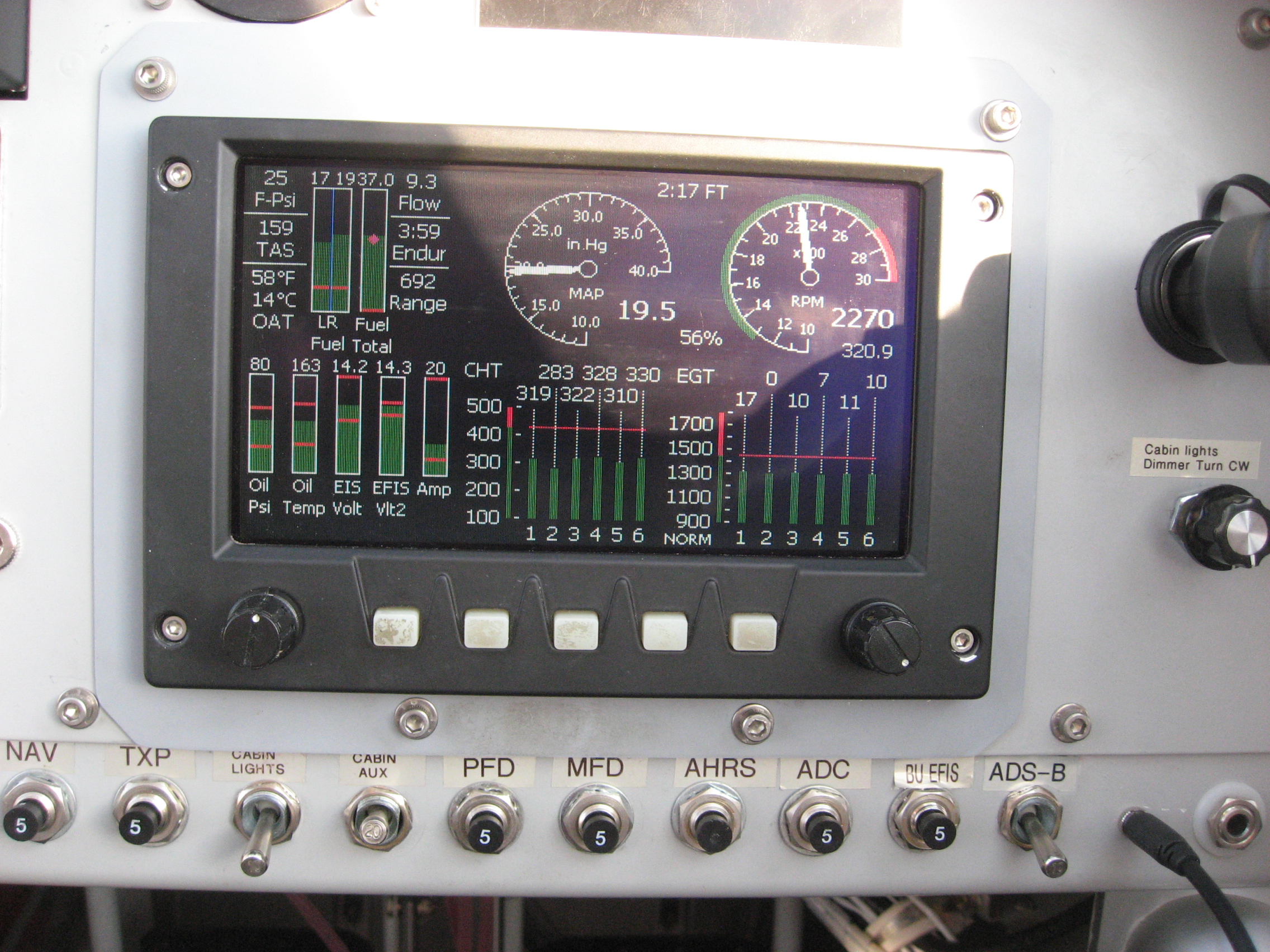

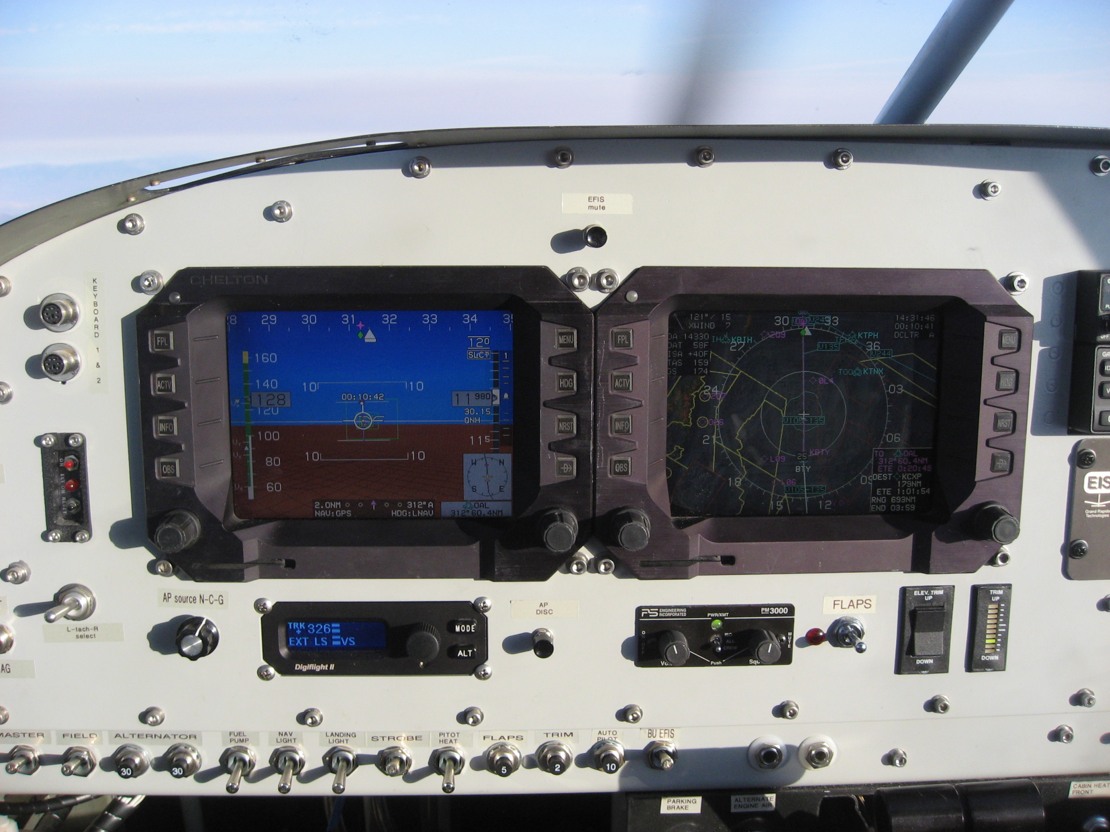

Just a few pictures of the trip to the RNO races. Weight was about 2300.

Your autopilot was out of trim...did you notice it when you were
flying? Looks like a good cruise though.

The autopilot is very sensitive; I can manually trim so that the electronic
trim wheel disappears but shortly thereafter it reappears due apparently to
slight pitching of the aircraft.

Interesting...I don't find that to be the case at all.
I find that if I trim for hands-off, and set the autopilot,
it stays pretty much 99.9% of the time until descent with
no out-of-trim indication. Very occasionally I get it,
but so rare that maybe enroute cruise I've only seen
the indicator a dozen or 20 times in 650+ hours. It does
come on during descents sometimes though if I don't
re-trim.
Do you have safety-trim or some other speed control
system that allows you to get the trim real precise?
Maybe for some reason your AP servo's sensors are
extra sensitive?

Do you have Trutrak's automatic trim?  IMO it's worth its weight in gold.

I could be wrong on the number...it's just off the top of my head.
Basically, it's just something that I almost never see DURING the
time I'm in cruise after I trim. I do have slow-speed trim,
due to safety-trim, so generally when I trim I'm trimmed out
so well that it would pretty much maintain altitude hands-off
for a bit. With the fuel being real near CG, it doesn't change
the trim too much during flight.
The other factor is that very many of my trips end up being
in still air. The RV-10 has allowed me to enjoy cruising at
altitudes more comfortable than my old plane would like.
At any rate, I very rarely see that indication, except for
when I've started my descent and have to adjust power and
speed. Heck, if I had said 50 times in 650 hours, it would
still be a really low number...but I doubt I've seen
it that many times in LEVEL flight in cruise. I differ
from Dave Saylor in that personally, I don't find the need
for auto-trim, because I don't mind re-trimming when I
see the indication on descent under AP control. I don't
think it would be a bad feature. I just have a personal
hangup in trusting another device adding to the complexity.
If it were free, I'd definitely have it, but it isn't
super cheap from what I hear. (Never personally priced it though)
But for money and trust, and since I've never felt it
to be a big inconvenience, I don't have it. I have heard
from at least 3 or 4 people who love auto-trim though, so
I must say that those who like it have vocalized it.
Those who haven't tried it probably won't miss it. I imagine
if I had it, maybe I'd be one speaking in big support, too...
..it's tough though as so far the RV-10 is so nice to fly
and I have so little workload, I can't see needing it to
be any easier.

I seem to see it a lot more in non-still air, of course, but I'd say
that in the 6 or 7 RV-10's that I've flown, I see it a whole lot more
than 20 times / 650 hours, but I don't see it every minute or two.
Again, it depends a lot on how still the air is. I imagine it also
makes a difference if you don't have the high-torque servo. I think
that shows out of trim a lot more than the high-torque one does.

> Do you have safety-trim or some other speed control system that
> allows you to get the trim real precise? Maybe for some reason your
> AP servo's sensors are extra sensitive?

You need to adjust your torque, sensitivity and micro activity settings, most likely.
...it's tough though as so far the RV-10 is so nice to fly
be any easier.

Trutrak gives you an inflight procedure to tune all the internal settings.  Follow their directions and experiment a bit and it should fall in line.  Maybe someone else with a sorcerer can post their settings, but keep in mind that would only be a starting point and from my experience every plane has its own requirements.
>> electronic trim wheel disappears but shortly thereafter it
>> reappears due apparently to slight pitching of the aircraft.

Make sure you have the pitot and static lines hooked up correctly. It they are backwards it will act as you have described.
be any easier.

Mine was behaving that way and I talked to Jim Younkin at Sun n Fun
two years ago. He knew right away what I was talking about. He had me
send the servo back in for some kind of adjustment and it has worked
fine since.
