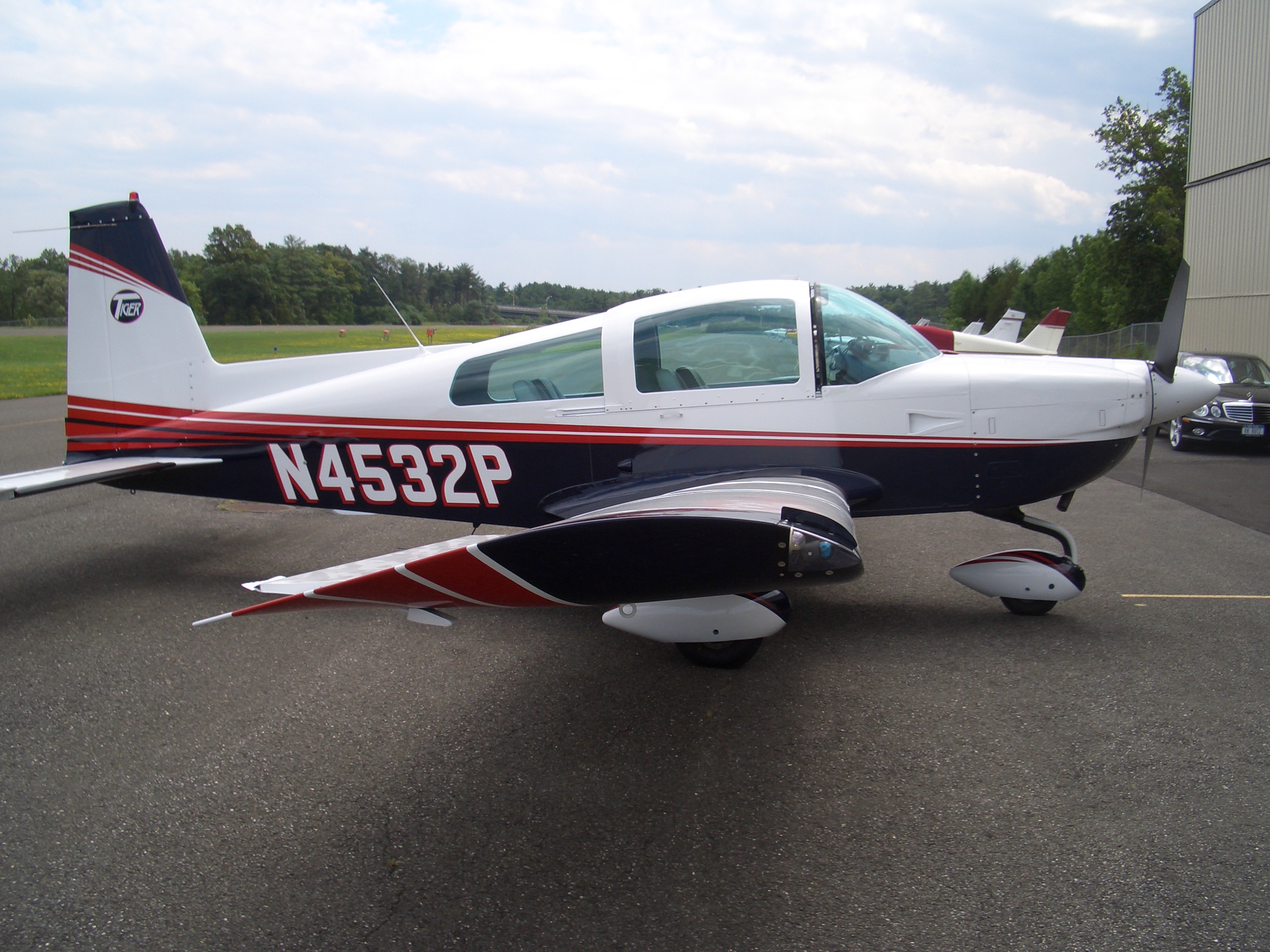

Looks like I will put the 63 back on but will this make much difference in ground speed?...Dick
New Paint N4532P, 1979 Tiger
