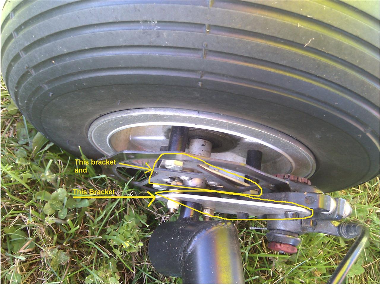

I have decided to replace the drum brakes on my Firestar with mountain bike mechanical discs. I was flying with an Aerolite yesterday and it looked like his brakes would work well for me. I need to create the bracket to hold the caliper as well as a bracket to attach the disc to the hub. I'm looking for recommendation as to the type of metal to use. I attached a picture so you can see the Aerolite setup.
It looks like aluminum will work. Not sure of the thickness or alloy I would need. What do you guys think?

Scott, I think 1/8" 2024-T3 or 6061-T6 would be fine for the plates. If it were me, I'd go with the 2024-T3 and alodine for corrosion protection. If you don't want to do the alodine, the 6061-T6 will do better even though it is a bit weaker (about 20%) than the 2024-T3.

I built my mtn bike brakes attachments pretty much as in the picture
that you sent...I used 6061 t6 .062 to mount the caliper... I used
bushing stock as spacers with through bolts to locate the disk ...Herb

Great, I went ahead and ordered the 6061-T6 in the .125
