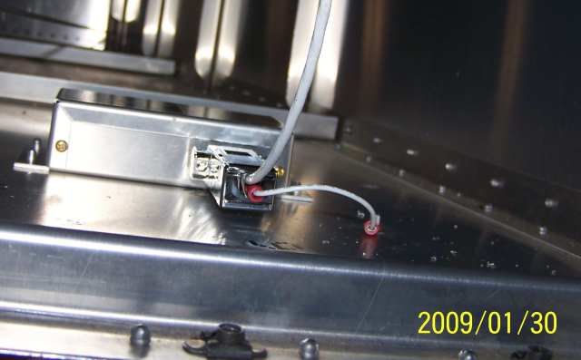

Hi Kevin,
I put mine on the fuselage floor under the baggage compartment.
A photo is attached . . .
Paul

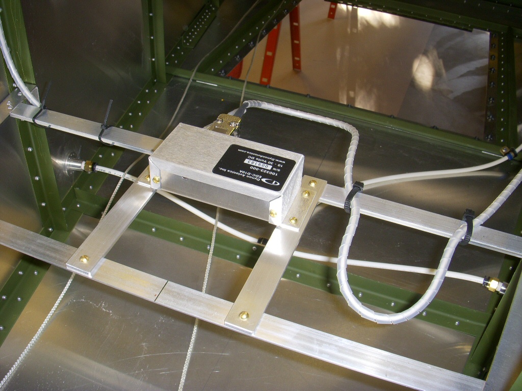

Kevin,
My remote compass is mounted in about the same place as Paul's. I placed it behind the access hatch, but I also made made a mounting bracket to level the unit. The Dynon instructions say to mount the compass within 1 degree of the panel mounted unit, a D180 in my case, in pitch, roll and yaw. Since the fuselage slopes upward towards the tail, my bracket counters that slope. Picture attached.
This has worked very well for me in the 2+ years I have been flying.

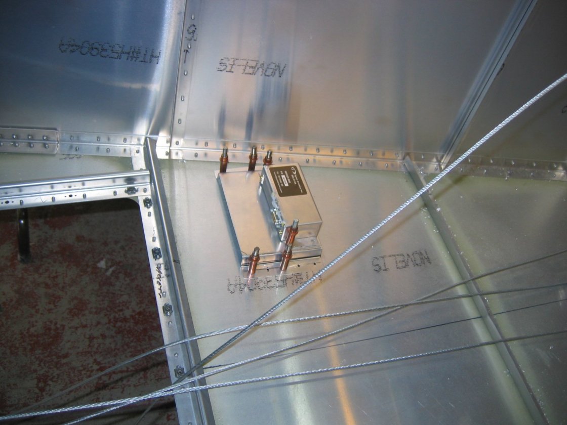

Kevin,
from the FWIW column...
Here's a pic of my solution. Not difficult if you have the trap door in.
They tell me this unit must be pretty close level with longerons and side to side.
