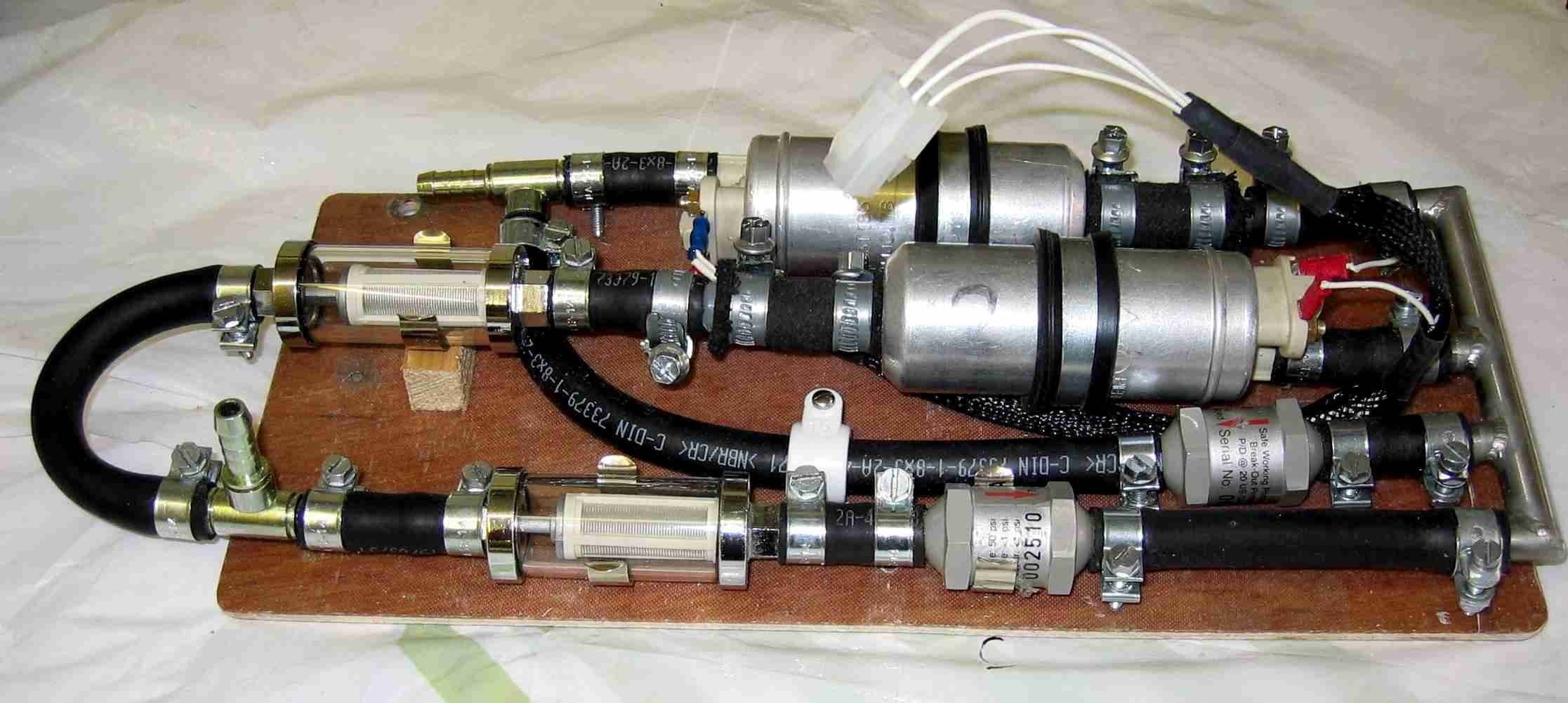

Attached is a picture of the fuel pump setup for G-IRON
Nice! I love that manifold you created.
But I can't help noticing that the springs inside the filters are
missing. Wink
Furthermore, I would recommend to use two separate electrical connectors
for the fuel pumps. It even looks like both pumps share a common ground
wire... and this makes the system very vulnerable for a single point
failure. After all, the whole point of having two fuel pumps and two
filters is to eliminate single point failures as much as possible. As
connectors are known for their high failure rate I would highly
recommend to separate all the wires and connectors for the fuel pumps as
much as possible! You are going to hate it if this single connector
fails due to some minor corrosion while you are flying over the channel,
taking both fuel pumps out of the equation at the same time...
Frans

PostPosted: Mon Sep 06, 2010 3:40 pm    Post subject: Batteries and fuel systems Reply with quote
Attention Will Daniels.
Hi! Will.
I think it should be said that the picture shown by Ian Rickard does comply with the fuel flow diagram suggested by the Europa Engineers and can be worked entirely by rubber pipes therefore excluding the specially made manifold as shown.
However mine is the same in modular form but for the fact that my filters on G-PTAG consist of two Mini-Andair Gascolators situated between the module and the tank exits. and arranged to allow easy sampling from the belly of the aircraft of both gascolators. Also I have the Graham Singleton tank connectors which easily facilitate water drains from each side of the saddle tank.
However from bitter experience I have also incorporated a tank top access panel (allowing annual inspection and mop out capability) whilst fitting the fuel depth gauge.

g-iani(at)ntlworld.com
PostPosted: Tue Sep 07, 2010 12:34 am    Post subject: Batteries and fuel systems Reply with quote
Frans
Thanks for your thoughts on the pump setup in G-IRON. You are absolutely
right about the electrical connector setup. We missed that when doing this
board even though I had separated them in G-IANI.
The filters are the later type with the cast centre section (not the tube).
These do not need the springs as the filter buts against a fixed stop.

Looks like you have more than enough to go on here but I'll chime in anyway - see:
http://www.europaowners.org/forums/gallery2.php?g2_itemId=48326
Happy building,
Dan
