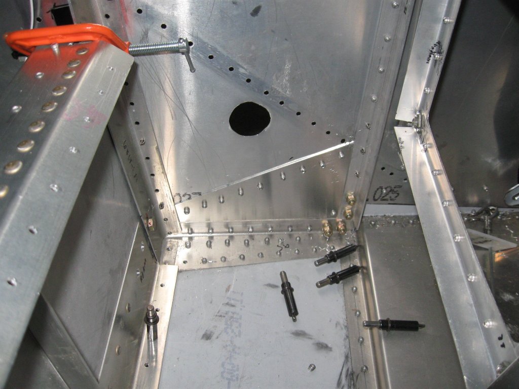

Hi gang
can someone please shoot me a picture of how this piece sits against the side of the fuselage skin and around the rear spar upright. I am a bit confused .
Does it sit fully next to the skin between the upright at the undercarriage and the rear spar upright
or
Does it go between the skin and upright at the back but at the front section you have side skin/spar upright/ 6zu3-2 and then the bracket 6B10-4 over the lot.
Chris..
the Zenith Aero video was not clear on this and the photo guide shows it going behind both I think..
a photos worth a thousand words
Chris

PostPosted: Tue Aug 31, 2010 6:33 am    Post subject: Re: center spar upgrade 6ZU 3-2 Reply with quote
Chris,
I installed it per your first assumption. I placed 6ZU3-2 against the skin and under all surrounding uprights and stiffeners. Picture attached.
Good luck,
 Filesize:  120.41 KB
 Viewed:  10691 Time(s)
David Gallagher
Cincinnati, OH area
Afterfxllc(at)aol.com

PostPosted: Tue Aug 31, 2010 6:15 pm    Post subject: Re: center spar upgrade 6ZU 3-2 Reply with quote
FWIW, I puzzled over this also and called Caleb at Zenith. Here is a picture of the outcome of that conversation on mykitlog.
http://mykitlog.com/users/display_log.php?user=rlendon&project=780&category=0&log=101653&row=7
I was able to drive the part up from below, the most puzzling part was did the verticle spar get sandwiched or not. Caleb and I agreed that it should be sandwiched.
I noticed Dave made it the other way, and I'm sure it's fine that way also. I just think, and Caleb agreed, the sandwiched joint it makes a stronger junction.

PostPosted: Tue Aug 31, 2010 11:41 pm    Post subject: Re: center spar upgrade 6ZU 3-2 Reply with quote
Thanks Ron and Dave
its a bit clearer now. my only thought was the bulge due thickness of new 3-2,pushing out the side skin of the fuse as you we are still using our existing rear spar upright & bolt holes.
Was this a problem?
on the Zenith builders photos it shows the ZU-3-2 as inside the Spar upright and the spar upright contacting the side skin? go figure..
Chris

PostPosted: Wed Sep 01, 2010 6:50 am    Post subject: Re: center spar upgrade 6ZU 3-2 Reply with quote
Chris,
As far as your concern about a bulge in the side skin, each airplane will have it's own best solution. In my case, adding both pieces under the upright seemed to fit better. It can certainly go either way. As far as a sandwiched joint making for a stronger upright, that could be, but I will not lose any sleep over it. A sandwich with 6B10-4 is only a one rivet sandwich. All this talk of sandwiches is making me hungry. Let's fly out for lunch!
Good luck,

PostPosted: Wed Sep 01, 2010 9:50 am    Post subject: Re: center spar upgrade 6ZU 3-2 Reply with quote
I also didn't sandwich the joint. It didn't feel right and like someone said earlier it is only a one rivet sandwich which I sincerely doubt adds much strength.
