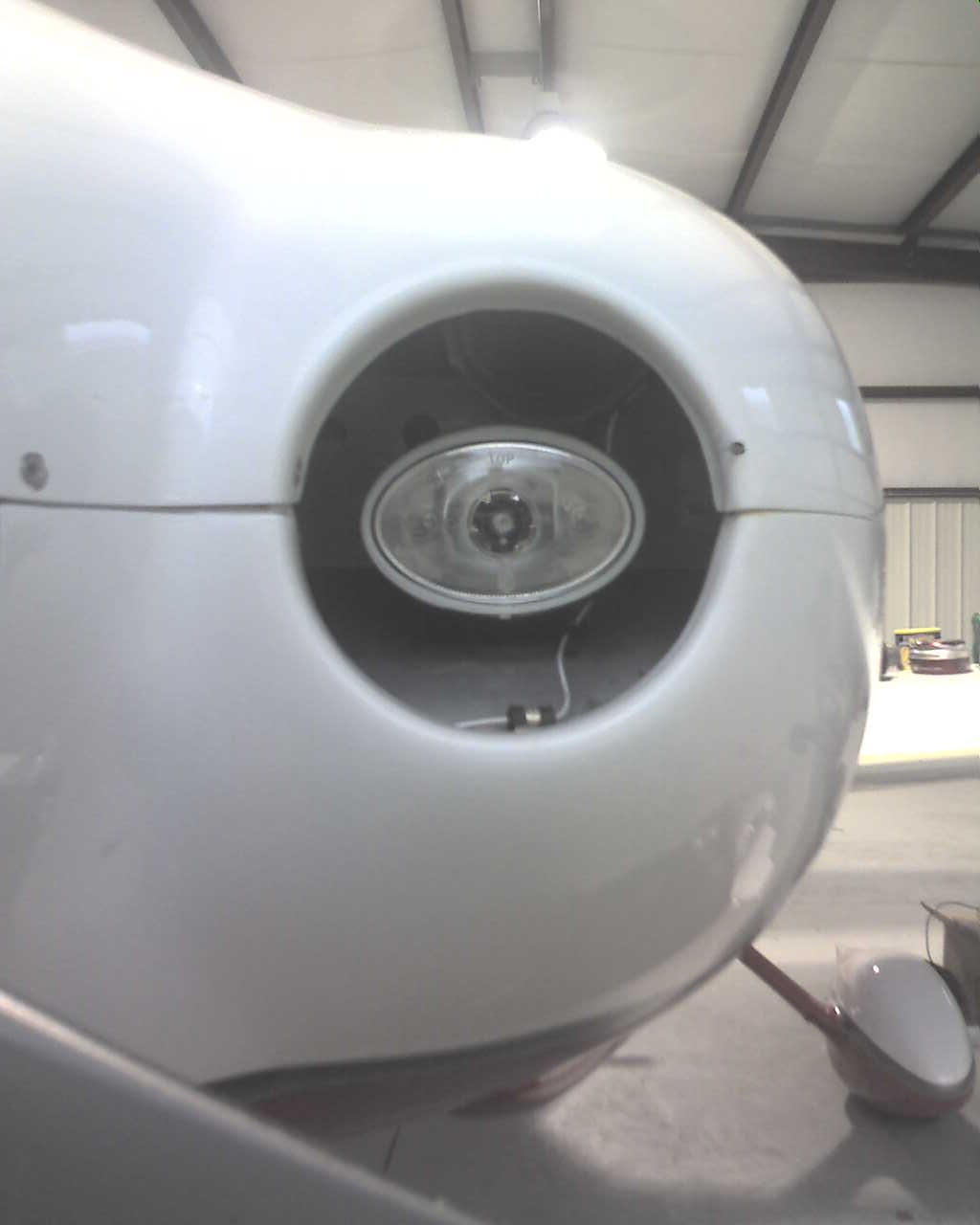

There was a Tom who did this. Hopefully the pictures will come through.
He had his light right inside the inlet on the cowls.

Has anyone put a taxi light in their cowl, or are most just aiming one
of two landing lights for taxi?
Sean #40303 fuse side skins

Not too many are putting the light in the cowl because with the engine
running you get a LOT of reflection off the back of the prop. At any
kind of engine revolutions the prop disc becomes rather solid and
reflects back most of the light trying to shine through it.

Cirrus use to mount their lights in the cowl inlets but since they were unable to cushion them effectively, the failed prematurely.  Cirrus has subsequently moved the single main landing light to the forward base of the cowl.  I'll be mounting my lights in the cowl just like they are on my Cardinal RG.  One oriented for landing, the other oriented for taxi.
On Van's Airforce forum, there was a picture of an RV-10 fro Brazil with dual cowl mounted lights.

Are you stating this from experience or ... truthiness?
This is definately not my experience with the dual cowl mounted lights on my Cardinal RG.  As mentioned in my other post, Cirrus also mounts a single HID light in the cowl.

Why put anything in the way of cooling air?

Experience.

Can you share some details on this? Type of light, etc?  Aircraft type?  Was this on an RV?
Unless the cowl mounted light was cycling at the same frequency as the propeller rotation, and the back of the prop was painted white, I can’t imagine how the light would be reflected back toward the pilot.
As previously stated many certified propeller aircraft have cowl mounted lights.  If your experience was borne out, I think those manufacturers would have altered that approach.

The halogens get very hot but HID do not.

I think the difference is that the lights pictured are in the cowl
inlets at the top of the cowl, where all certified aircraft lighting in
the cowl is near the bottom of the cowl. You only need to look at the
projector based product that was displaying a heads up EFIS on the back
of the prop to see how reflective it can be.

That's not my point. Like James cowl users found, something as simple as a deflector in front of an injector causing various air pressure and flow changes....in that case a positive one.
So why stick a big lightbulb right in the path of airflow coming into the cowl and plenum when we spend time trying to make air ramps and smooth flow transitions. Seems pointless to me when there are plenty of superior lighting positions to choose from. Why in a cowl inlet?

PostPosted: Thu Sep 02, 2010 3:31 pm    Post subject: Re: HID Lights Reply with quote
Geez Tim, I already fitted one light on my cowl. I bet you are REALLY going to hate it.

PostPosted: Thu Sep 02, 2010 4:38 pm    Post subject: HID Lights Reply with quote
HA! Hey, but you can say you spent less than anyone else
on your lights. Smile

Sean, mind if i steal your idea? This should fix my James cowl injector problems with those positive air pressures. Smile

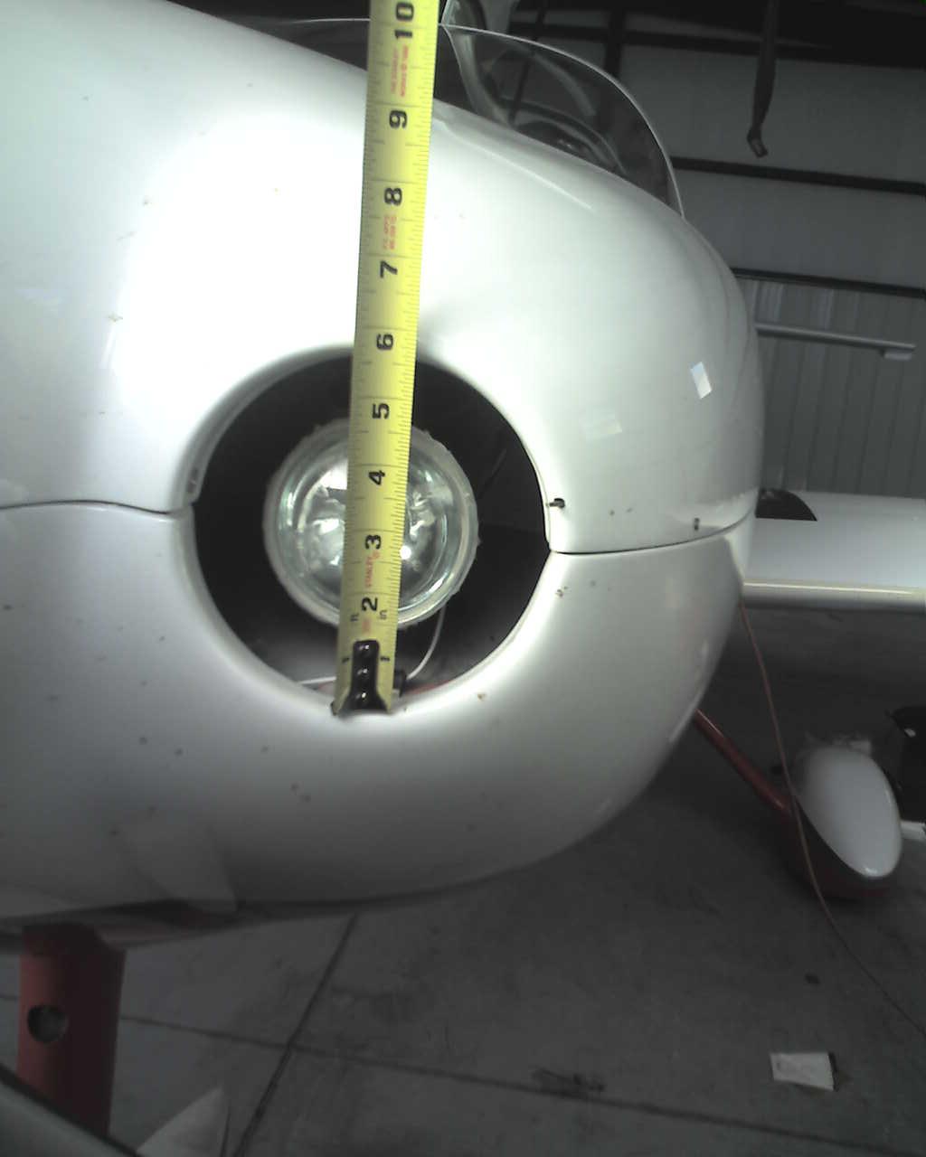

I think Kelly (and William) hit it bang on. The Cessna Cardinals have the lights down low in the cowl, so there is no reflection back into the cockpit from the prop. Certainly I have never seen any in mine.
Thx for the opinions. I will be ordering the Duckworth's 35W D1S HID with the Phillips bulb.
Another question then begs an answer. Why the left wing for the landing light as opposed to the right?

I think the difference is that the lights pictured are in the cowl inlets at the top of the cowl, where all certified aircraft lighting in the cowl is near the bottom of the cowl. You only need to look at the projector based product that was displaying a heads up EFIS on the back of the prop to see how reflective it can be.
