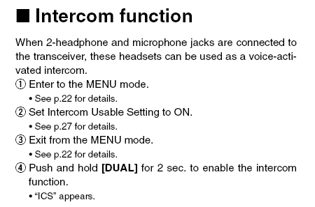

Funny you should offer this assertion. Here's a clip from
the Icom A-210 Manual at
http://aeroelectric.com/Mfgr_Data/Radios/Icom_A210/IC-A210_User%27s_Manual.pdf
From page 20
[img]cid:7.1.0.9.0.20100829223457.0202e848(at)aeroelectric.com.0[/img]
From page 27
[img]cid:7.1.0.9.0.20100829223457.0202e848(at)aeroelectric.com.1[/img]
They use the words "voice activated" but the switching
is suspicious. Provisions for an external intercom PTT
suggests that it's not really voice activated but in fact
a "hot mic" system that is turned ON by either the
front panel control as described above or ON/OFF by
external PTT switches wired to pin 10. I'd bet that
the built-in feature is indeed a PTT intercom.
Bob. . .

Bob,I have one of these units. It works as voice activated to my satisfaction. It my have some components that I do not understand, but voice opens the squelch and squelch closes when silent. Many menus to filter through, but once set it is a fine unit.

THANK YOU! There's no data better than hands-on
data. That's what I would have hoped for. I've got
some REALLY warm spots in my heart for Icom products
that were established back in the days when I was
putting repeaters on 1200 foot towers!
Do you use the external intercom ptt switch?
trumanst(at)neitel.net
PostPosted: Tue Aug 31, 2010 5:38 am    Post subject: Icom 210 radio intercom switch Reply with quote
No I do not. When the PPT is keyed, BOTH mics are hot. I just tell my passengers to be quiet when I transmit. While flying alone I cancel the intercom all together. Just pushing and holding one button on the face of the unit will cancel the intercom function. Repeat and it is back on.
Kevin
Good info.
