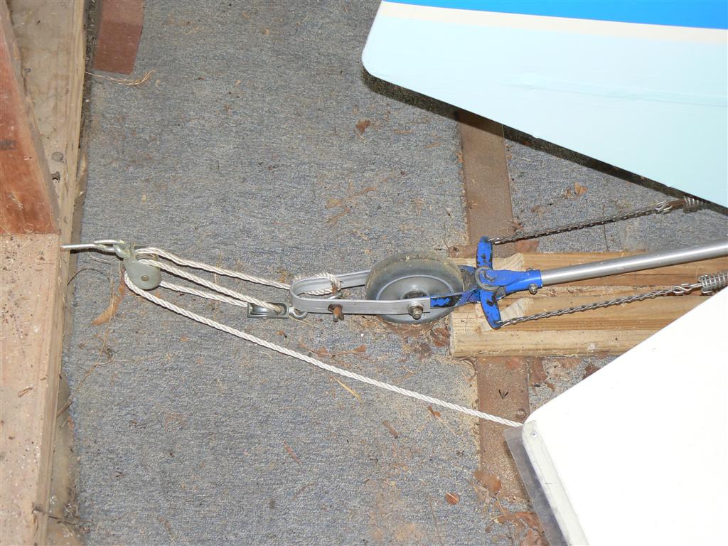

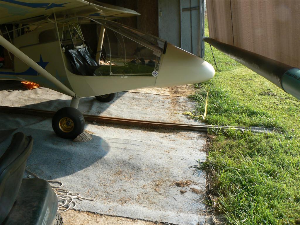

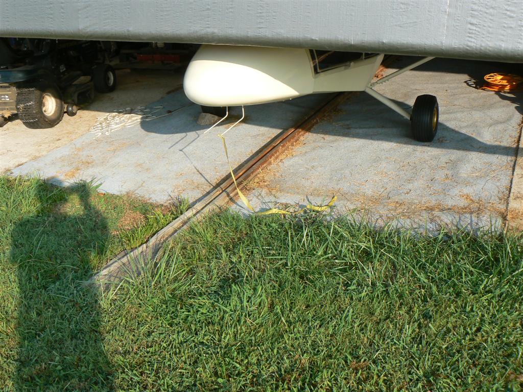

I know how you feel because I cannot push my plane into the hangar without help, because it is uphill. But this pulley and track setup works great. I need the track because the hangar is built on a slight slope, and not only does it slope toward the front, it also slopes toward the side. So without the track to guide the tailwheel, the airplane tries to crawl sideways when you winch it in. You may not need that.
When I taxi in, I spin the tail around before shut down so that all I need to do is attach the yoke to the tailwheel, then I stick a BIG screwdriver (2 handed pull) through a loop in the end of the rope and just start walking backward away from the hangar. When I get it pulled all the way in, the tailwheel drops off the end of the ramp - then I know it's time to quit.
Maybe you can adapt something like this to your situation. It makes it possible to get the airplane put away single handed.
Don't have any ideas about how to get it out tho - Make a towbar and use the tractor?
