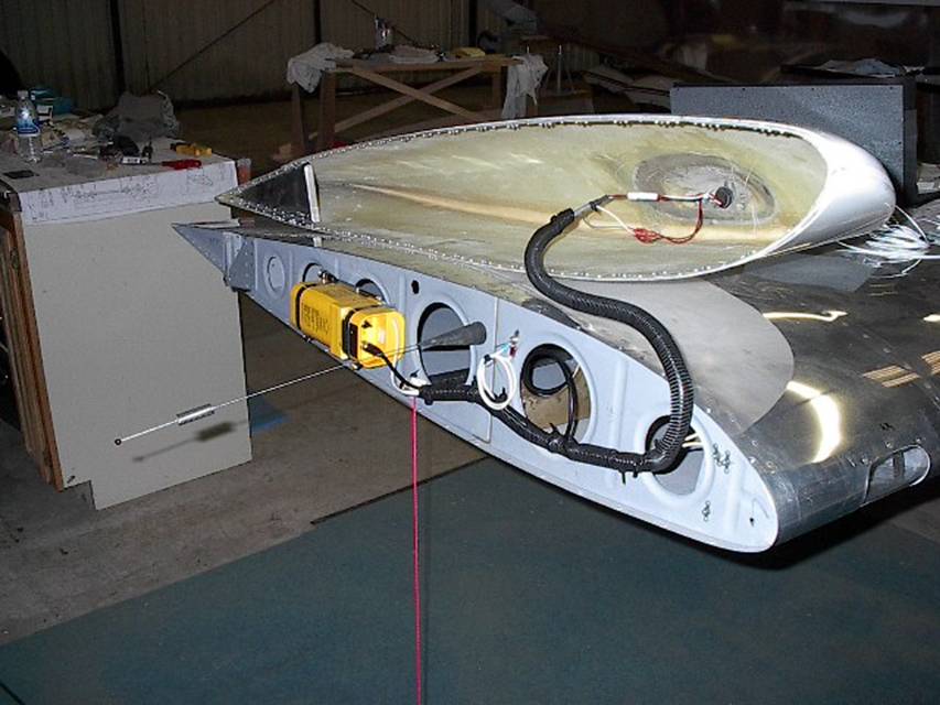

PostPosted: Thu Aug 26, 2010 11:24 am    Post subject: RV-8A Ideal ELT Location & Antenna Reply with quote
I installed mine on the wingtip.
Vince
RV8432 at 63hrs
