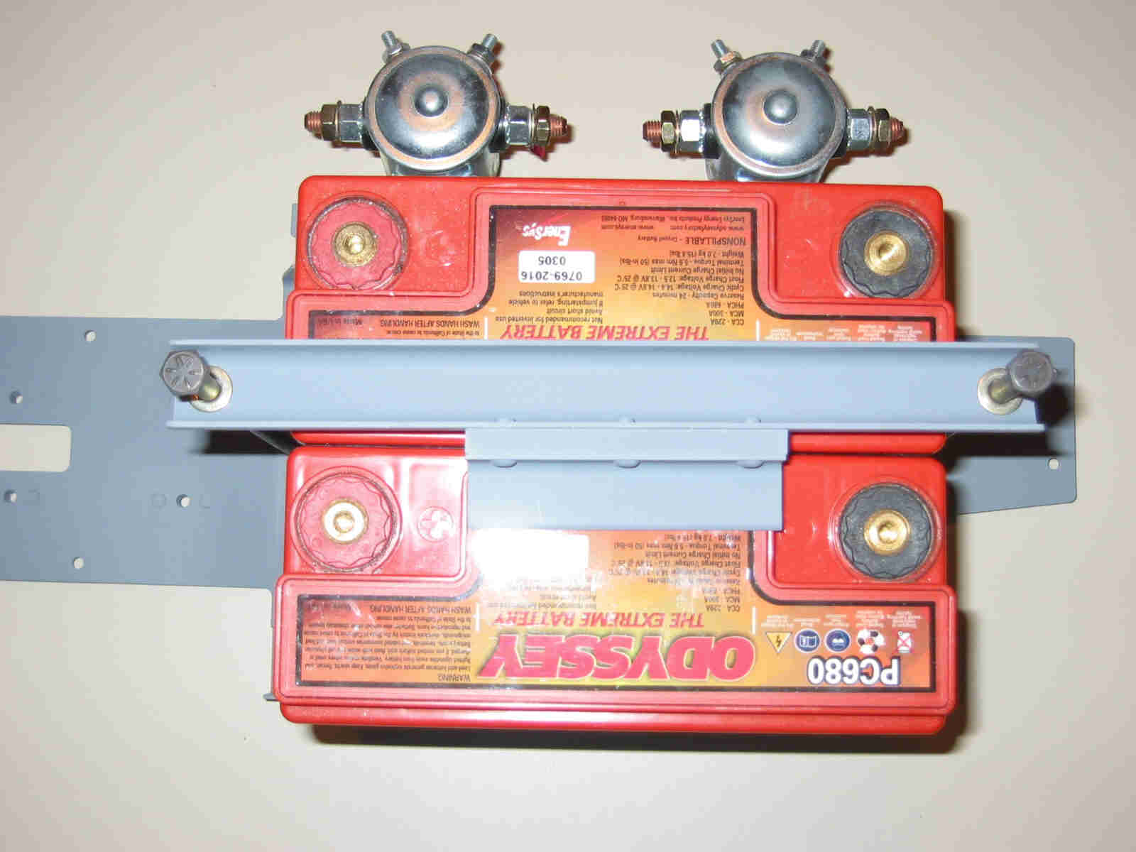

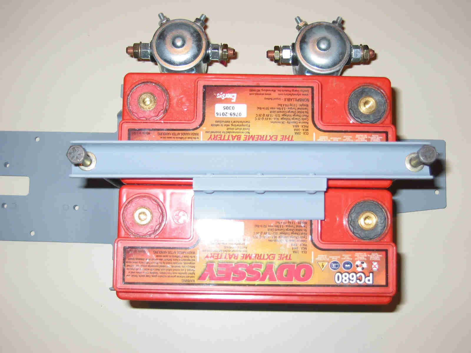

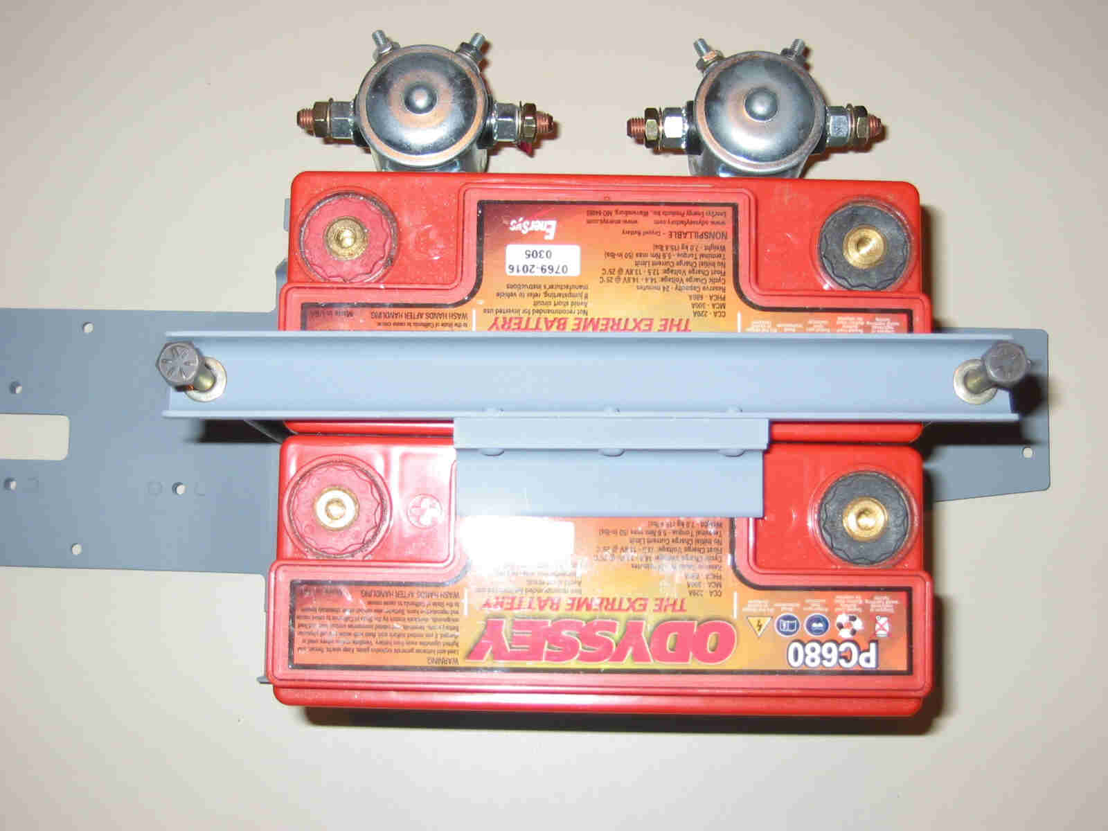

I went with a pair of PC-680s.  Tray was modified to increase width a small amount (around an inch).  Contactors (one for each battery) are on a bracket that attaches to the standard contactor location.  I’ve attached one picture – if you need/want more I can send them offline if you’d like.  I’m also aware of another builder that has a pair of PC-680s but they’re rotated 90 degrees from “normal” and the contactors are one on each side.
Bob #40105
 Filesize:  97.01 KB
 Viewed:  1070 Time(s)

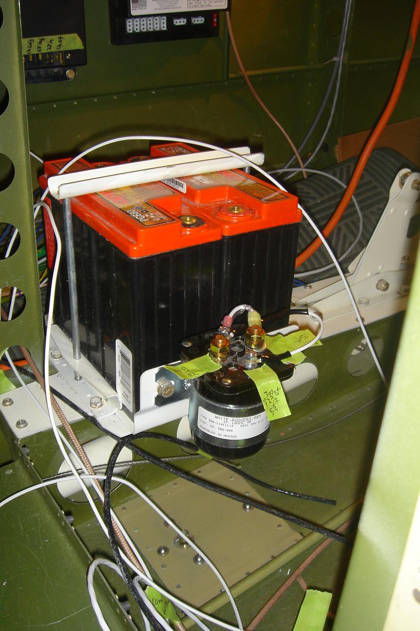

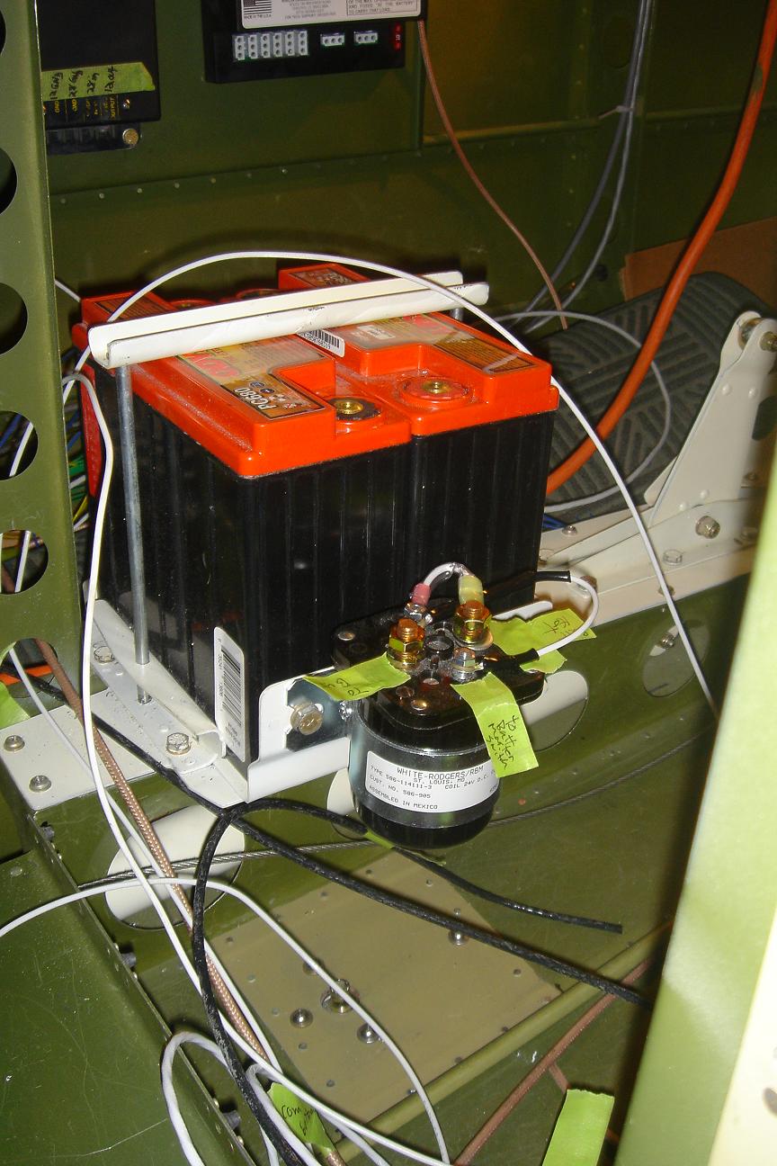

Well, if we're sharing battery pictures, here's our main battery:  12v + 12v = 24v.
Also in view is a real man's contactor . . .
TDT
40025
 Filesize:  170.69 KB
 Viewed:  1088 Time(s)
bob.condrey(at)baesystems
PostPosted: Wed Jan 11, 2006 8:47 am    Post subject: battery Reply with quote
Tim - I guess you win the “manly contactor” contest…
