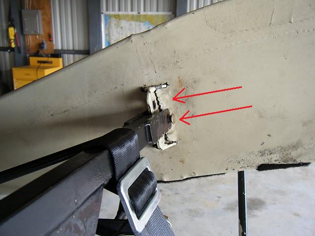

PostPosted: Sun Aug 08, 2010 6:58 pm    Post subject: Re: Two settings for wing Angle of Incidence. Reply with quote
Crap. Wish i never asked now, because thats a little unsettling. Oh well....it still flies well.
Here is a pic:
Wing spar, two holes.
 Filesize:  36.7 KB
 Viewed:  8688 Time(s)

PostPosted: Sun Aug 08, 2010 9:55 pm    Post subject: Two settings for wing Angle of Incidence. Reply with quote
I'd say the original builder screwed up when he drilled the upper hole and corrected it. Both my Mk III and my Firestar are drilled in approximately the same as the lower hole. It's your experiment, but I'd leave it where you have it if it was me. As Beauford says, "Worth what ye paid for it".
Rick Girard

Eugene Zimmerman
Posts: 392
PostPosted: Mon Aug 09, 2010 5:22 pm    Post subject: Two settings for wing Angle of Incidence. Reply with quote
242,
In the picture, the hole that has the pin looks to me like it is in
the normal plans built position.
I'd guess someone tried to improve on Homer, and discovered Homer knew
what he was doing.
