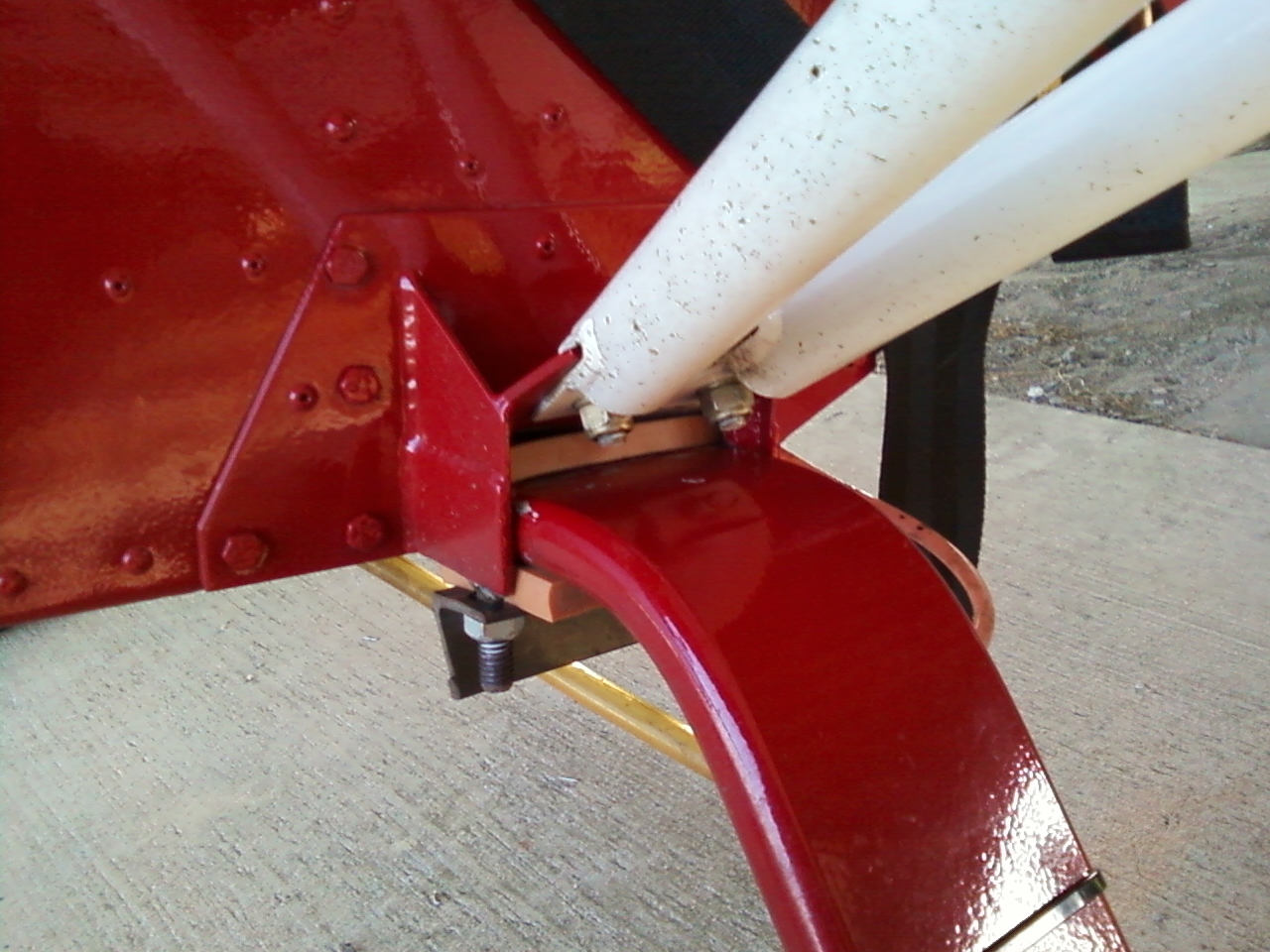

Hello all,
On Saturday, I was able to install the new rubber spacers from Zenith, I flew her 220 miles home. Thus ends what is most likely the most stressful week I have had in aviation.
I want to present a few questions:
1. how do I determine the bolts are tight enough on the gear.
2. Should the gear "give" at all when braking. Mine still does... Not much.. but maybe its not tight enough.
I want to thank you all for your help. You will see that I used your suggestions during the work on Saturday. By the way, if you ever get a chance, stop in to KJFZ. Those are some fine people.
The new spacers... tight enough??

PostPosted: Sun Aug 08, 2010 4:15 pm    Post subject: Main gear spacer failure -- a happy ending Reply with quote
Hi Jesse;
  Nice job on the repair. You are one lucky guy. To give an opinion on your questions. I looked at the picture showing the urethane blocks - I torqued the clamp nuts to 90 in. lb. on my plane, this compressed the blocks a little. I would tighten the A3 bolts to the top limit of torque for that size of bolt to allow for the drag of the nylon lock - 25 in. lb. FWIW if you have the drawing set and other documentation for your aircraft I think for a small charge you can get the factory support. The construction standards are an excellent source of information.
Regards, John
