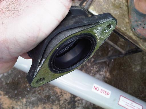

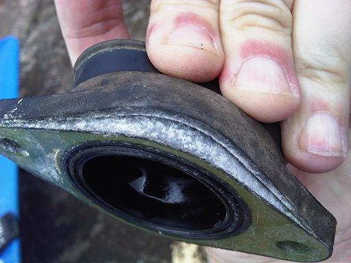

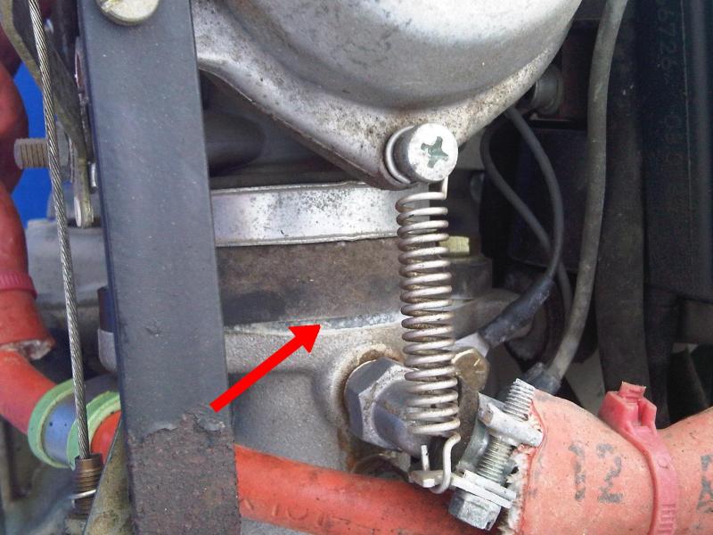

I have problem with the Rotax 912 carburator sockets were the rubber get separated from the steel insert part.
In my club, almost everybody with 912 engines, has exactly the same problem with these carburator sockets showing the same type problem.
Please look at the pics. My 912 is like 18 months old and it only have 52 hours of use and this part have fail. Also, you will see a white powder. I dont know what is that.
Also, I was checking the net and found this company that produce 912 socket carburators in USA and they say they are better than the Rotax ones.
http://jbmindustries.com/
Have any one have try these JBM 912 carburator sockets? Are they better?
THX,
Isaac

The white powder is probably the result of corrosion of the aluminum, i.e. aluminum oxide. I've not seen this type of separation of carb sockets before, the usual failure is cracks in the interior of the socket that causes air leaks and can destroy the engine.  There was a bad batch of sockets produced a few years ago that were fitted to both the 912 and the HKS engines. I replaced mine with the JBM units and have seen no cracking since, although inspection and replacement of the carb sockets is a regular maintenance item checked off at 100 hour and annual conditional inspections.

I have used the JBM Industries sockets with great success and cost savings on more than one 912/914 engine. I think they are as good as, or better than, the ones sold through Rotax at twice the price. BUT, looking at your pictures the real problem is moisture. Everything has a layer of corrosion on it. Your environment seams to have a lot of moisture and that is the problem. It looks like you will be replacing the carb sockets and probably other items as a regular scheduled maintenance requirement.

This is corrosion and most likely from water or a very high humidity area. Once it starts this process the rubber will come away from the metal. If you live in a high moisture environment I would spray down a large part of my engine and exposed parts (metal and rubber) with Boeing T-9 (my first choice as it is a more dry application) and Corrosion -X is my second choice (a little wetter after it is applied). These will block out the rain or moisture.

Thank you all for your replys. Well I live in Panama Republic of Panama, Central America. Here the humidity is almost 100% Crying or Very sad This is like living on the middle of a rainforest.
I will follow your advises and use Corrosion-X or similar product to spray around that parts after I use my UL.
I will advise my other friends to do the same.
I Hope this cure this problemo.
