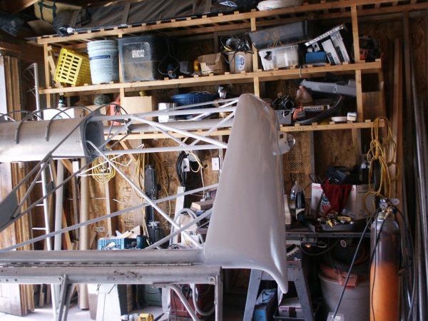

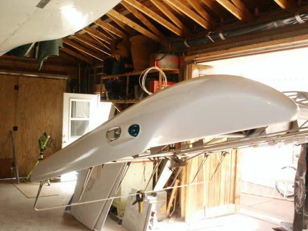

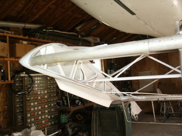

Bob,
Here's some photos of my homemade drop tips.
Mike Welch
MkIII

PostPosted: Mon Jul 19, 2010 1:38 pm    Post subject: Re: Kolb FS II wing mods/adding droop tips Reply with quote
Nice Droop tips Mike.javascript:emoticon('Very Happy')
Of What and how did you make them?
I see you did not extend your wing spars?
Travis show me some at Kolb for the MkIII.
I like your nav & strobe lights,
What has changed from adding them do you think?e\
How do you think they would do on a F S II?
Thanks for any info.
