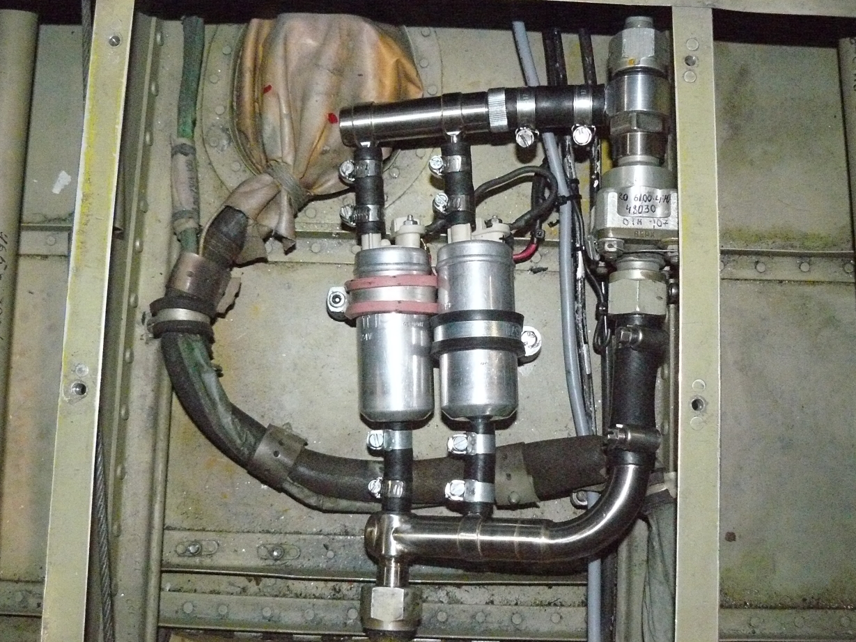

Hi Stefan,
you may have one faulty coil in the mag, but white spark plugs are no symptom of a shot coil - the contrary. As you said you are running the Yak on part auto fuel. And we had real trouble with that in hot weather - no take-off at 100 % power possible in the 18 T . A fill-up with avgas helped, no other actions required. So the real problem was vapour bubbles in the fuel pump at high rpm. As this pump is not particularly good in sucking we added an electric pump in front of the service tank to feed the engine-driven pump. This Pierburg pump should deliver ~100 liters per hour at 0,5 bar nominally, but was at its limit in times, so we added another one for safety and since we never had a drop in fuel pressure to critical limits when using pure auto fuel for some years now. You´d be lucky to find avgas at 10 Dollars per gallon these days in our continent and this won´t be getting better we feel ...
So, Stefan, please watch the fuel pressure closely on the take-off run or static at minimum 80 or 90 % power. If you leave the plane a few hours in the sun to heat the fuel in the tanks you might observe a dramatic effect on fuel pressure ... We remember Franz U. had a moment when taking off in A. airfield last year in his 18 T so we just cannot believe there are not more reports from other Yakkers confirming this behaviour on mogas in hot weather.
Most "modern" low wing aircraft have electric fuel pumps required for take-off and landing as a safety feature, so we definitely like to suggest installing an electric pump on any Yak for added safety. The picture below shows the system in our 18 T, another one-way valve added for the electric pumps.
To check the tank vents : You could plug all vents and open the drain valve under the fuselage : The fuel flow should stop in a short time. Then open one plug and watch the flow - satisfied with the amount of fuel ? OK, plug the vent and open the other one, the flow rate should be the same. It is unlikely that all vents should be blocked, so the Yak should run OK on one tank alone - and it should run on one mag as well with negligible power reduction. So we suspect a mogas effect.
Apart from that - Stefan, time to see us once again.
Helga and Vic
