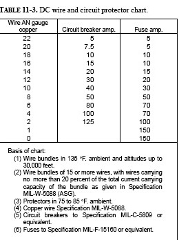

I have 15-20' round trip of 20awg wire going to it, so I know a 5A
fuse would protect the wire. I plan on using this as a boost pump
for my mechanical, turning it on before startup, check the
pressure, then some seconds later crank the engine. It would then be
turned off at altitude and back on for landing. The boost pump is
near the bottom of the cowl, ~1' below the mechanical pump. They are
in series with no recirculation, so it would be pumping with no flow
until cranking.
If it's 20AWG, put a 7A fuse in an don't loose
any sleep over it. Having too robust a feeder
protection cannot put anything inside the pump
at risk.

Facet told me in an email 5A would be fine, I see from Table 11-3 of AC43.13-1B a 5A fuse would work, and you say 7A is peachy. So I'm happy and will think no more about this issue.
