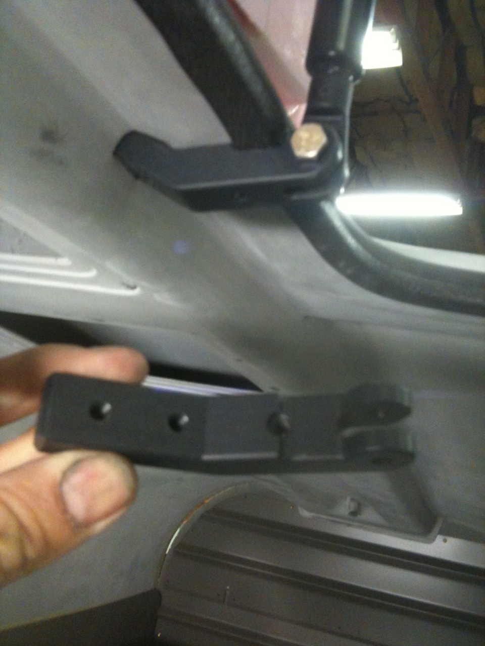

I made a set of these for my plane and I would like some feedback. These move the strut a little lower so the hinge covers don't interfere with the strut. They also have a cutout for the McMasterCarr seal. The geometry is basically the same as the stock bracket. They are made out of nylon and can withstand a lot of abuse. I have been letting my doors spring open and shutter at the extent to test the strength of the nylon. I have done this probably sixty times and so far so good. They are drilled and threaded so they can be retro-fitted or newly installed. No nutplates needed. Oh ya, they come with a short 1/4 inch bushing for installation instead of the 4 washers. Sorry for the crappy picture.

I like them, how much are you asking for a set?

Vans sells them at 24.40 each. I was thinking 40 for both in the long run and if there is a demand.

Put me down for a set shoot me a e-mail how you want paid for them.
