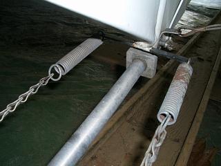

PostPosted: Tue Jun 29, 2010 6:48 am    Post subject: FireStar Tail Wheel Rod/Spring Reply with quote
Bill,
Seems like all of them fit a little loose.I tried this and it works really well.first hacksaw 2 cuts in the tube end,one vertical and one horizontal,which lets the tube end compress around the new rod.Also drilled a new hole through the tube and rod, (near the old hole) for good register at that attach point.Its a 2 piece aluminum clamp using counter sunk cap screws.
G.Aman MK-3C
[img]cid:tie_8CCE5B12DA77E5F_642C_9239[/img]
 Filesize:  13.49 KB
 Viewed:  11293 Time(s)
